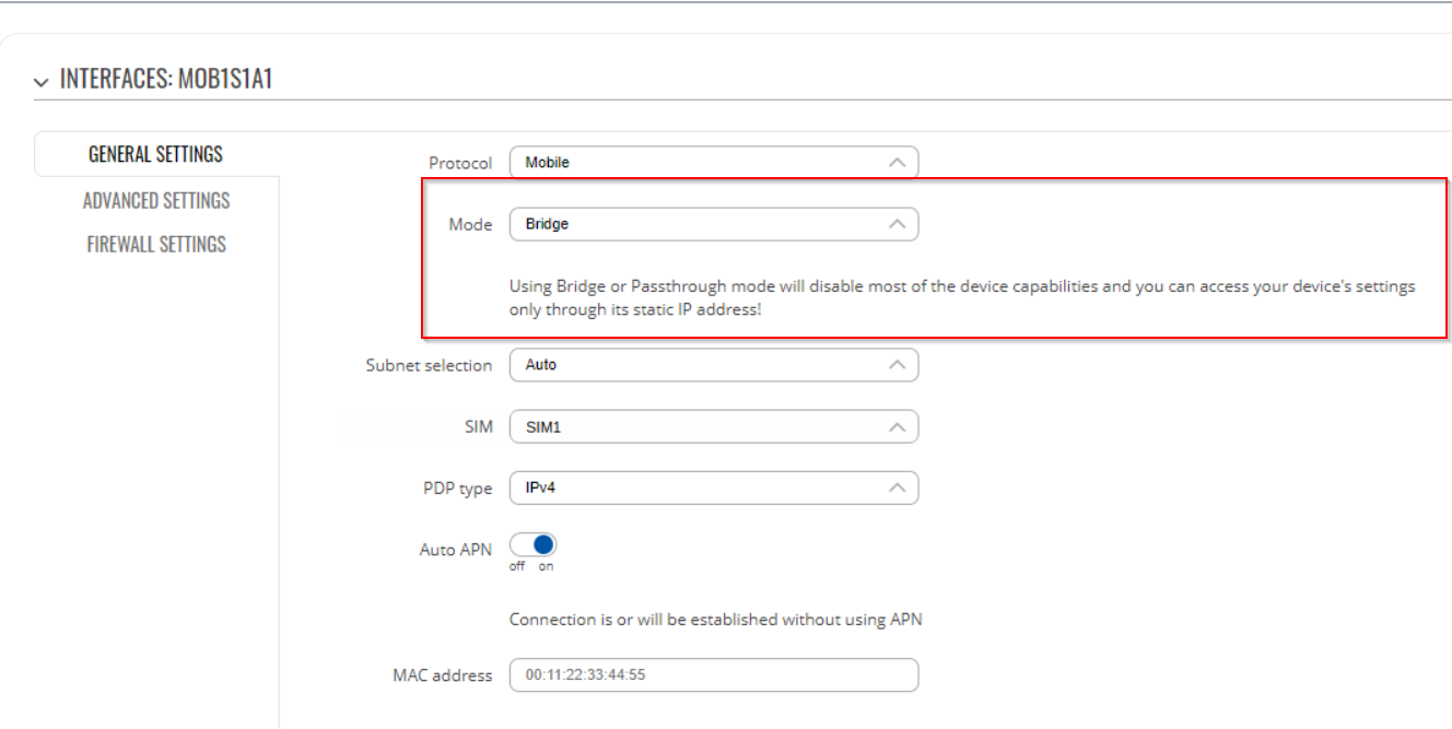

During my test I tried to change in Interfaces>advantage Settings> Mode from NAT to bridge ( see below) and now I am not able anymore to access the Router using the IP 192.168.10.1 ( RUT955 loging IP ). Do we have a possible solution to solve this ? I tried to assign a static IP to my laptop like 192.168.10.100 without success.
BTW the next step will be to RESET the router to factory default and to reconfigure it from “scratch” without using the back up. Any other additional inputs from your side ? I will keep you psoted.
Thanks for now and have a great weekend , ciao
Oscar
Make sure you have only one WAN interface on your PC. Setting a static IP and an appropriate netmask should make the device reachable even in bridge or passthrough modes.
If this does not help, I’m afraid a factory reset will be the best option here.
