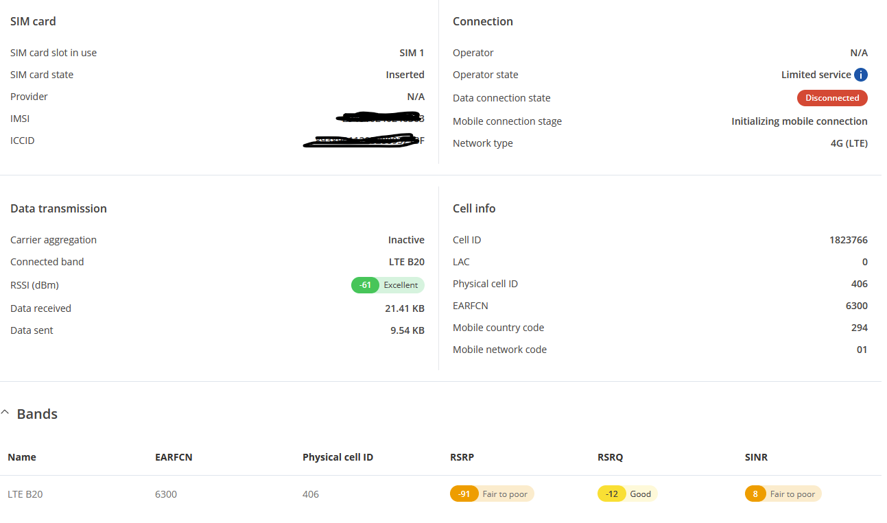

What am I missing and why after so many years of using SIM card with fixed public IP I am no longer able to do so with the latest RUT955s ?
Screenshot of the screen where it can be seen that the router just waits for mobile connection to occur, but it never does.
