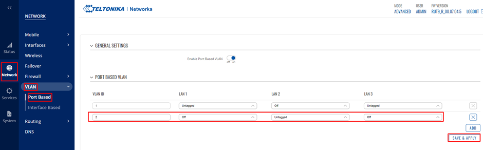

Next, navigate to Network → Vlan → Port Based
Now you’ll need to add a new VLAN.

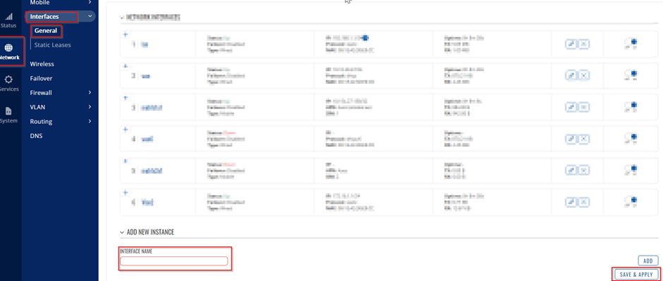

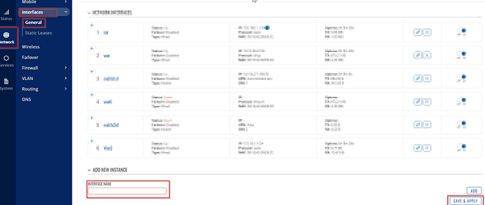

Now navigate to Network → Interfaces

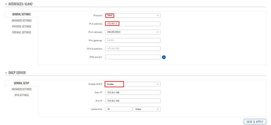

Add a new instance.
Now a new window for your interface configuration will pop up:

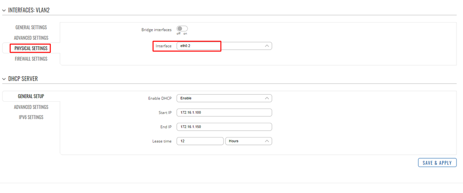

Next, go to the “PHYSICAL SETTINGS”
Select your newly created VLAN in the Interface drop-down
- if you’ve configurated everything correctly your new Interface should be running like in my case:

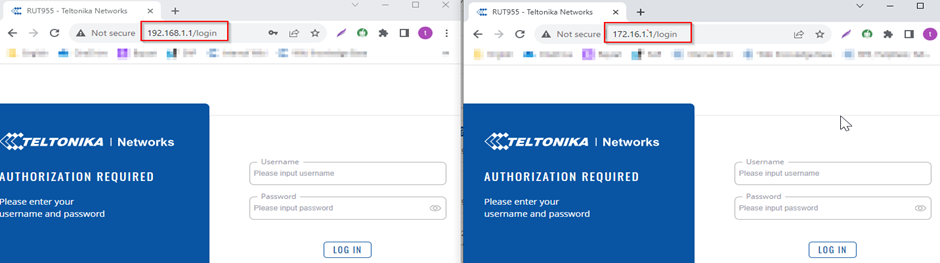

- Now I can access WebUI by typing both of VLAN.

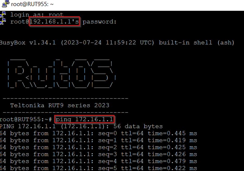

- I have connected to the device with the IP address 192.168.1.1 using Putty. After establishing the connection, I attempted to ping the IP address 172.16.1.1, and I can confirm that the ping was successful.
