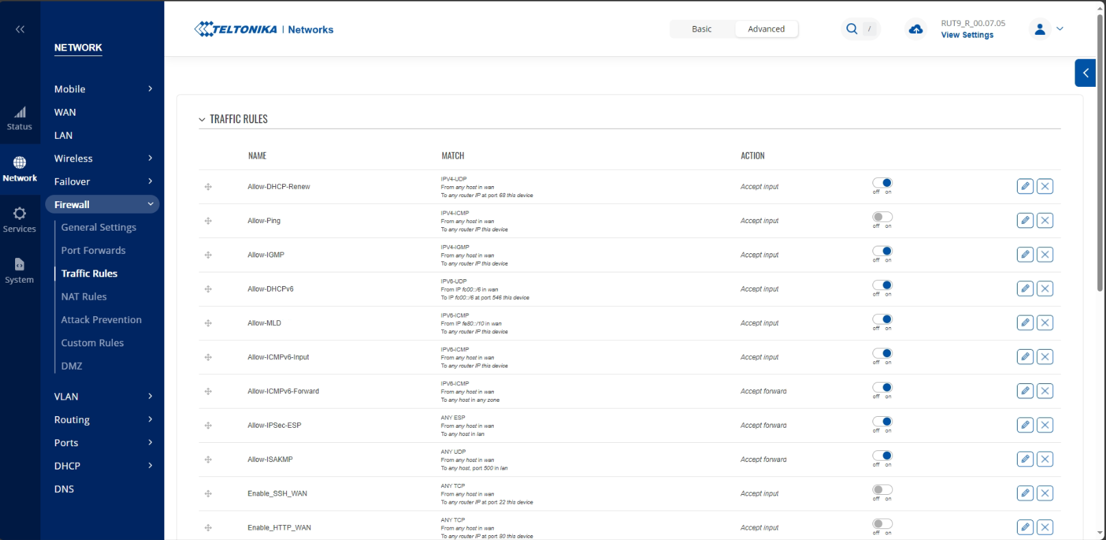

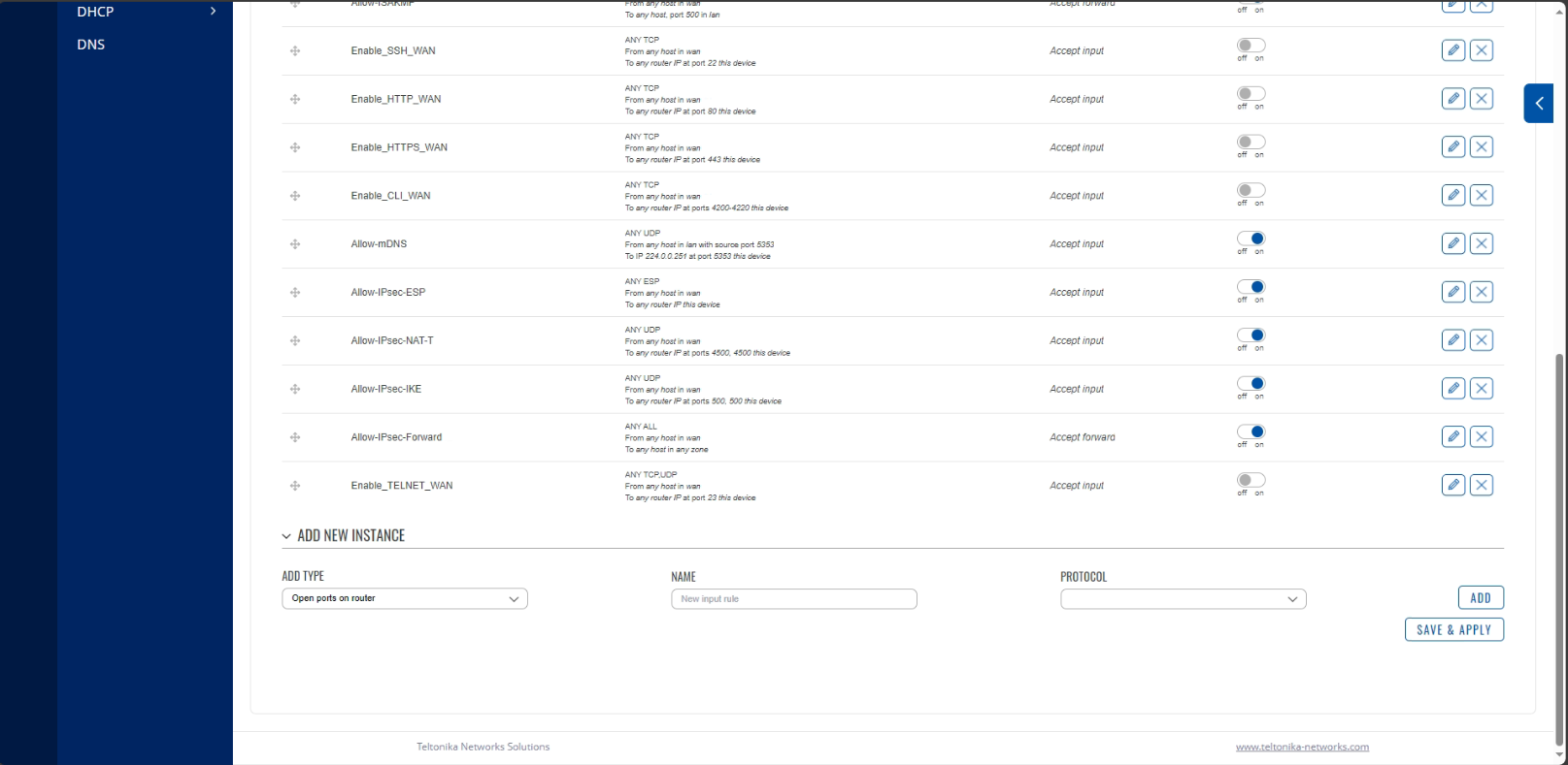

Here is what ive got in the firewall port forwards

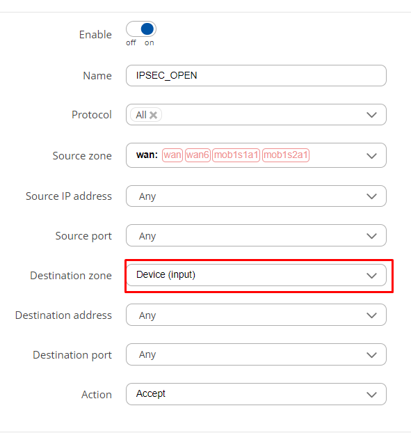

Could you please try adding the following traffic rule?:

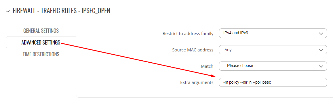

And in advance rule settings make sure to add -m policy --dir in --pol ipsec
as extra arguments:
Let me know about the results.
ok thanks it’s working like that can you explain me a little bit more what it does Thanks

IPSec is not really a VPN, so it is different than other VPNs. It does not have its own interface or a firewall zone. It basically matches IPSec traffic and uses the WAN interface to send the encrypted traffic. So in this case, you have created a firewall rule that allows all traffic from WAN that matches IPSec policies (in extra arguments) into the RUT955 itself. So with this rule, only IPSec traffic from WAN should be allowed to RUT955 itself (device input).
