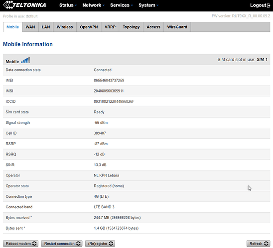

Hello again. I have situation in NL. We have 2 routers 150m apart, facing in same diraction. System with RUT955 is wokring ok (normal mobile speed) but system with RUT956 is wotking slow (very slow mobile data speed). Both routers have the same mobile provider. Only difference i noticed is LTE band that they are connected to at the same tower.
Do you think the issue could be in router version or anytheing else?
Thanks for info.
Klemen
Screen shot of 2nd router…
First, I would suggest updating both devices to the latest firmware versions.
Secondly, it is possible that the devices chose different bands, and thus, one of the devices is slower than the other. After updating the devices, check what frequency bands are used. If you see that one of the devices provides better speeds, you can lock the other device to that band as well. This can be done in Network → Mobile → Band selection.
Also, ensure that software flow offloading is enabled in Network → Firewall.
Let me know how it goes.
