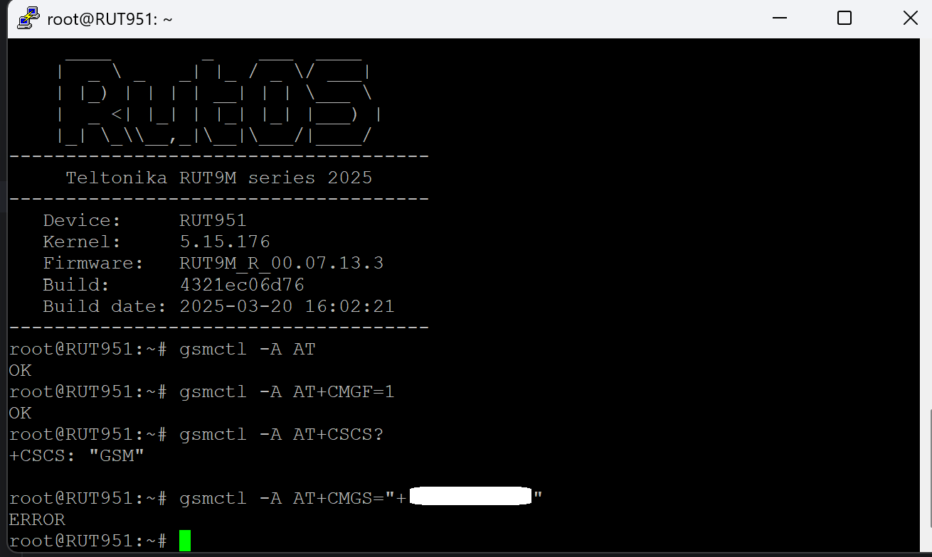

I give the following commands:
gsmctl -A AT → response OK
gsmctl -A AT+CMGF=1 → response OK
gsmctl -A AT+CMGS=“+1234XXXXXX” returns ERROR and doesn’t show “>”
If I execute the command in this format (gsmctl -A “AT+CMGS=”+1234XXXXXX""), the “>” sign appears, but after I write the message and press CTRL-Z, the process goes into the background and stays there without anything happening.

I also tried the method presented on the website https://wiki.teltonika-networks.com/view/Gsmctl_commands.
After sending the command gsmctl -A ‘AT+CMGS=“+1234XXXXXX”’, the GSM modem gets stuck, and I have to restart the router to use it again.
root@RUT951:~# gsmctl -A AT
[handle_requests:429] error: Failed to handle AT exec. ERR: Request timed out

Hello
I have updated to version “RUT9M_R_00.07.13.3_WEBUI”, but I am still encountering issues.
Could you please verify them and let me know if there are any errors in the commands?
Additionally, I have used two SIM cards from different operators, but the issue persists in both cases.
