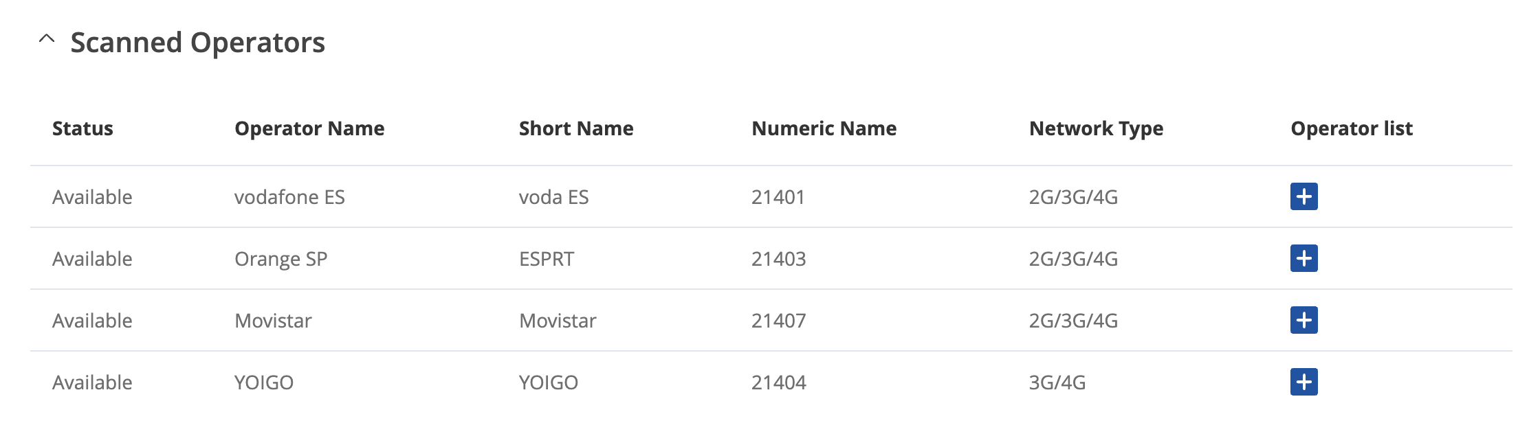

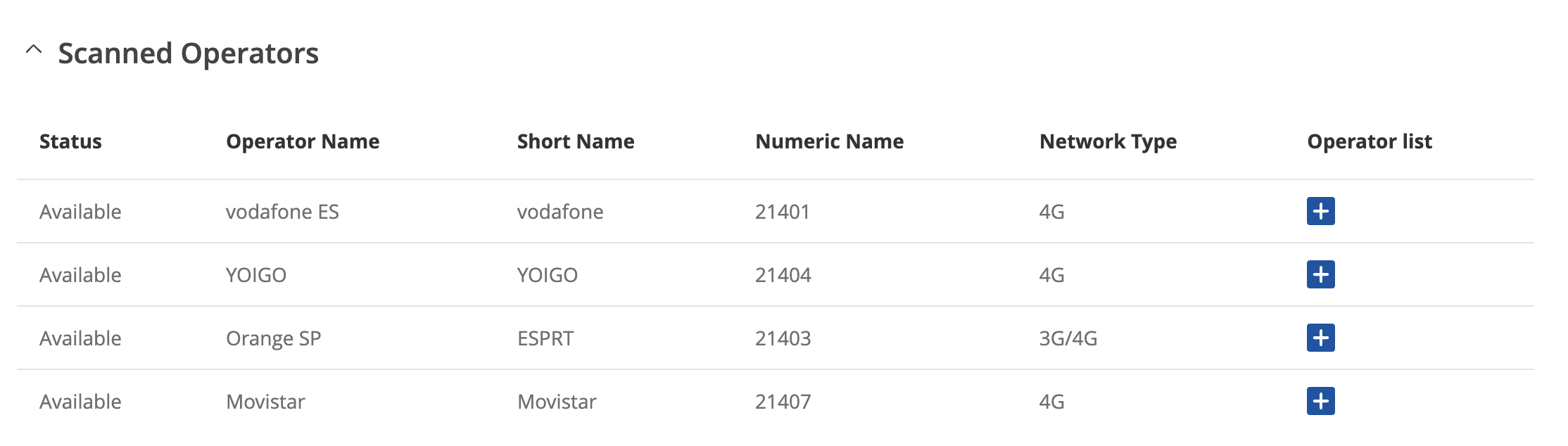

The only thing i have seen different between models configuration is when scanning the Operator:
TRB: I have connection with all but not with Yoigo:
RUT: Orange is the ony one that connects:

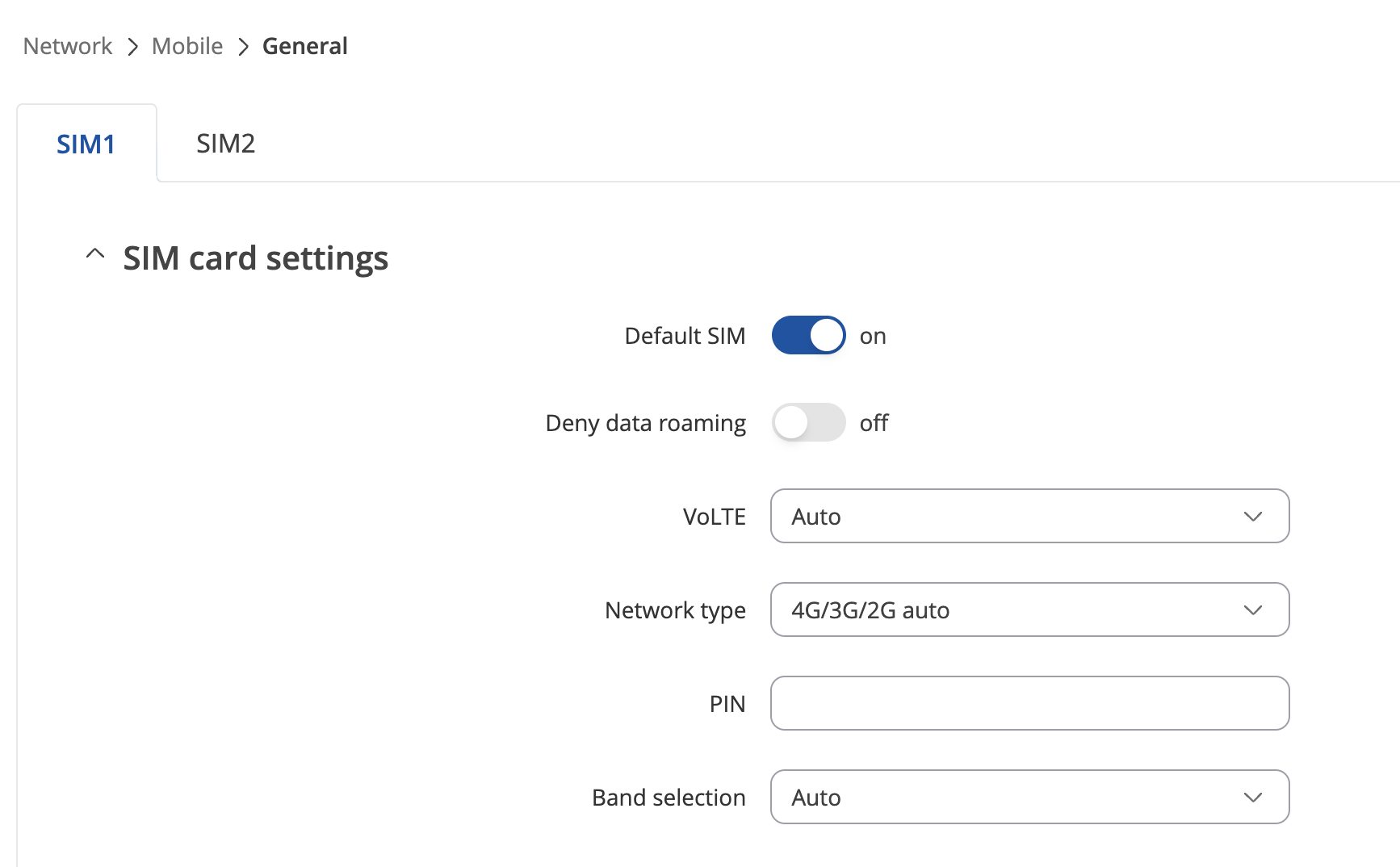

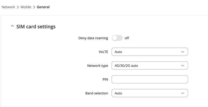

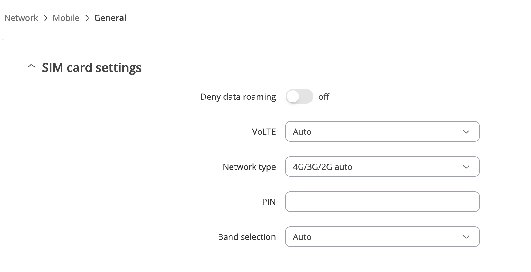

Maybe something related with Network type?
Is RUT and TRB have same network types configured?
Are all antennas attached?
Yes, same antennas and newtork types in Auto Mode in both routers:
TRB:

RUT:

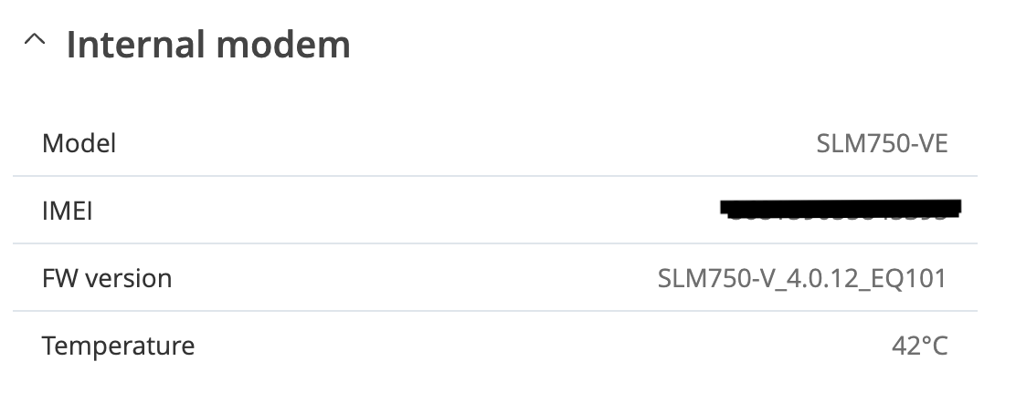

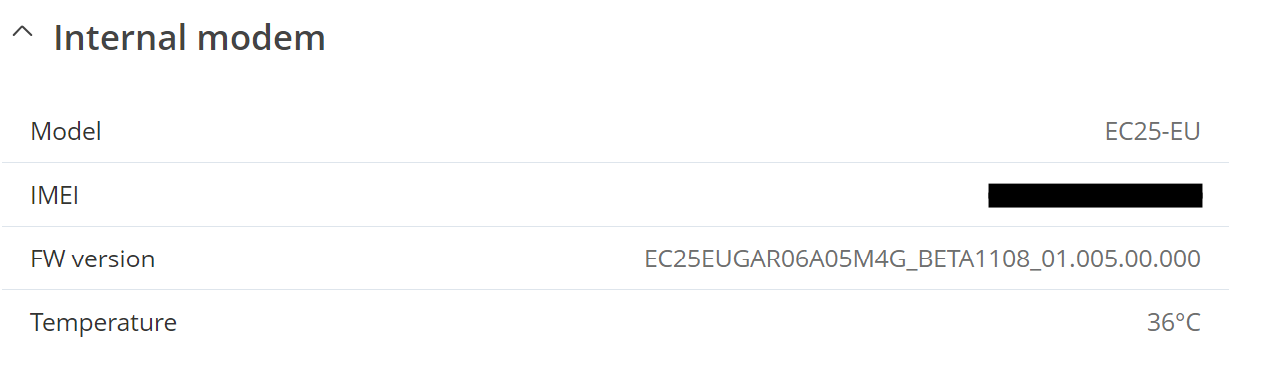

I mean, what modem firmwares are, not the router’s. You can check it in firmware update page in WebUI
Both versions are quite old, hmm. If APN is correct and all settings are the same, maybe I suggest to contact your SIM provider, maybe they can provide you more information about why RUT cannot connect to the network.

Is there any way to check the latest version and download the modem’s firmware in the web? I only see the Firmware of the device itself…
