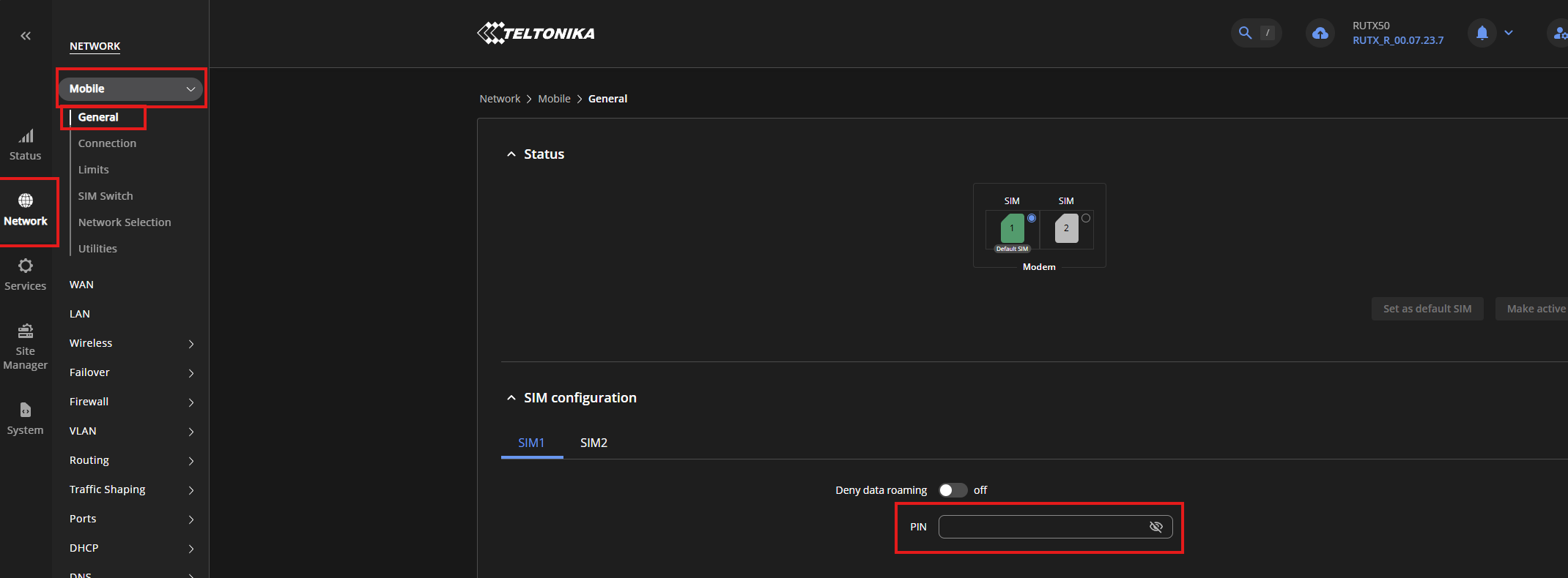

Check if you have entered the correct PIN code inside the device WebUI settings (Network → Mobile → General)
Don’t forget to click “Save & Apply”;
