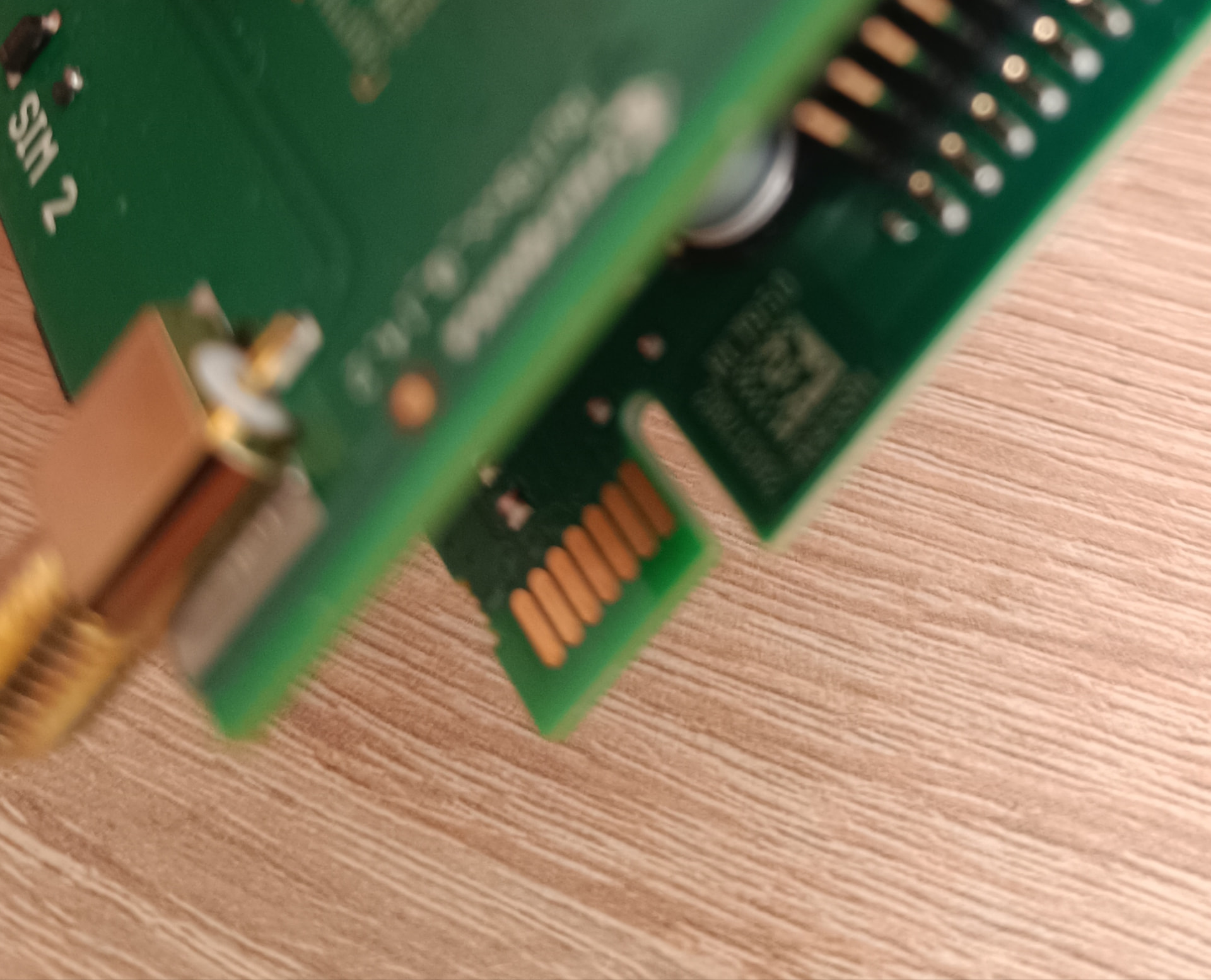

Hello, which pins are GND, RX and TX? For connecting UART.

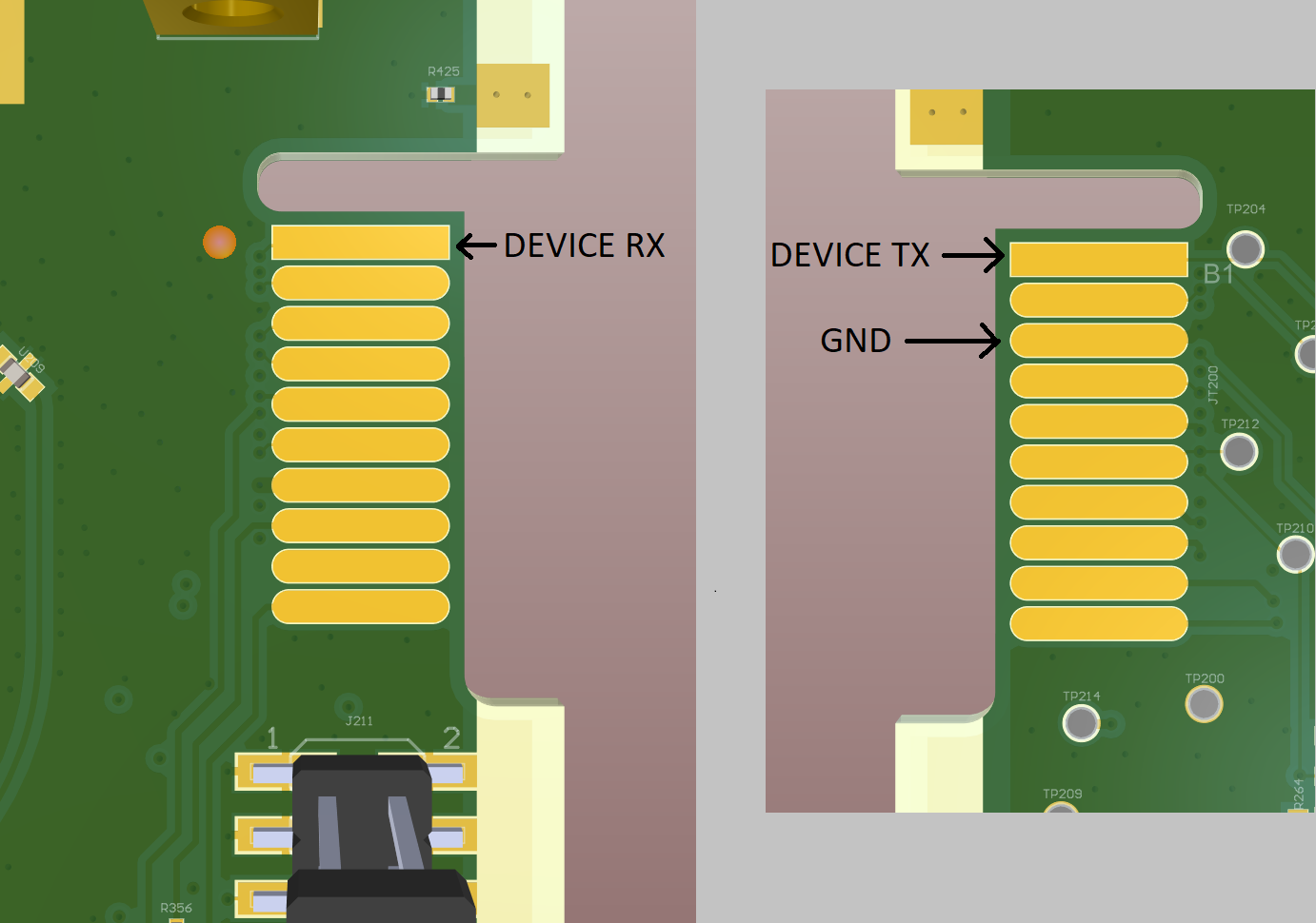

I have received an update from our R&D team regarding your query. They have provided a detailed scheme of the pinouts for your reference, which is attached below:
In case you have any additional questions, please don’t hesitate to ask.
