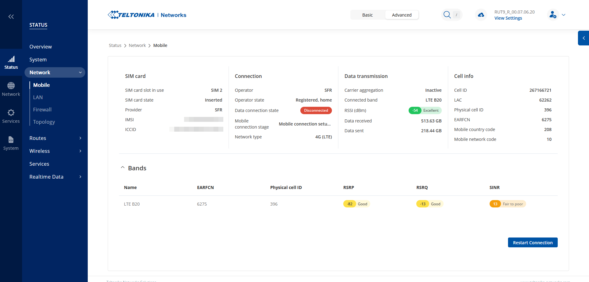

My RUT950 suddenly lost mobile data connection like 10 hours ago. I was not modifying any of its parameters, and it did not automatically upgrade its firmware. Now it is stuck in that state :
The same SIM has been tested on a phone and allows data connections. I’ve tested 2 other SIM on the router (one from same operator, one from another operator) but connection state remains “Disconnected”. I’ve updated to latest firmware with no luck.

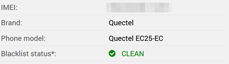

The IMEI is not reported as blacklisted according to https://www.imeipro.info/ :
