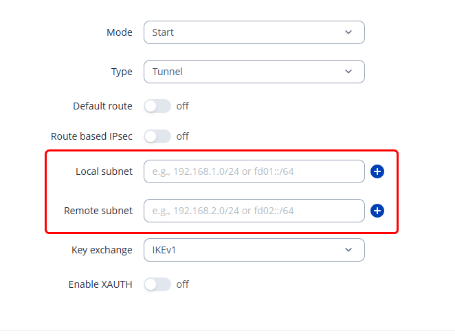

Now ,for allowing access through IPSec, nothing extra needs to be done, as the subnets/addresses that you’ve configured under Local and Remote subnet settings, are the addresses which will be allowed to access the router:

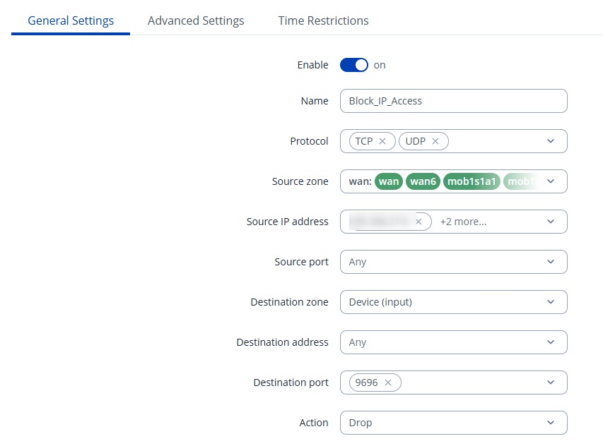

So basically, any device under, for example, the 1.0/24 or 2.0/24 subnet will be able to reach the router. If you want to block any specific IP addresses, you can do so by utilizing the Firewall Traffic Rules with a rule such as this:
