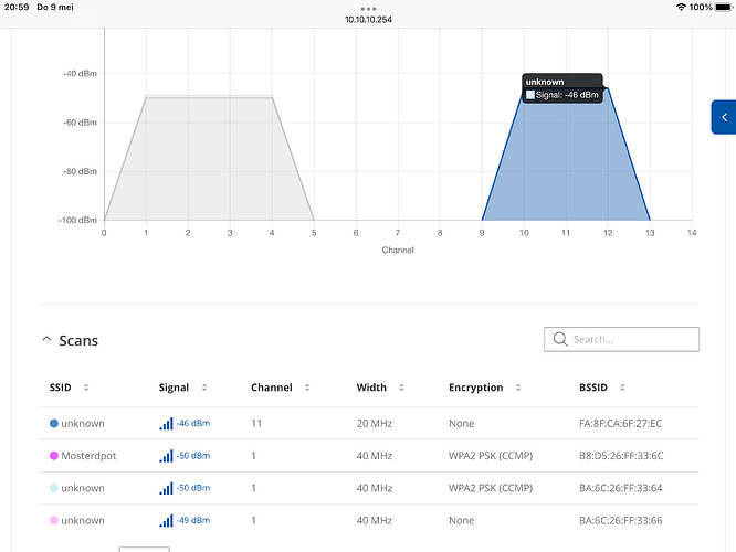

If you’re experiencing issues and you’re sure there haven’t been any extra settings changed, it’s possible that your WiFi might be operating in a congested band or channel. To check, go to Status, then Wireless, and select Channel Analysis to perform a scan. If your wireless access point is in a congested area, consider switching to a less crowded channel. You can do this under Network, then Wireless, and finally Radio.
Weird that it is named ‘unknown’. But there obviously is no congestion.

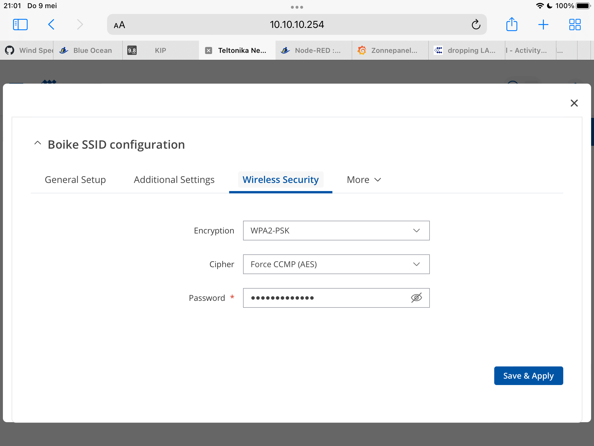

Also strange is that it says ‘none’ for encryption, while:
