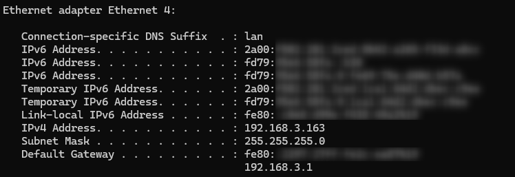

I’ve attempted to do the same exact setup as you’ve described. I’ve forced the PDP Type to be IPv6 on my mobile interface and have done nothing else. After confirming that the interface now had an IPv6 address, I’ve connected my laptop directly to the LAN of my device (RUTX11) and reviewed my IP address via the ipconfig command in the Windows CMD:

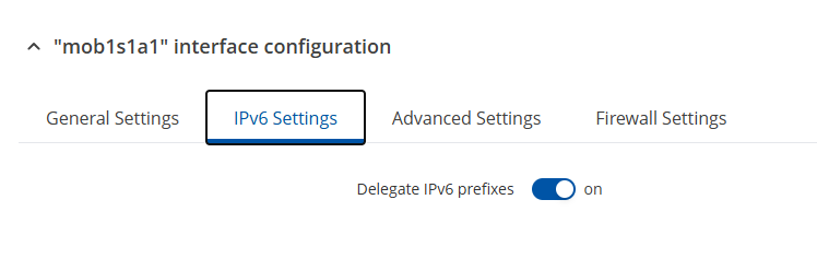

I have not changed any DHCP-related settings whatsoever, although, I had to ensure that Delegate IPv6 addresses was enabled on my Mobile interface settings under the IPv6 Settings tab:
