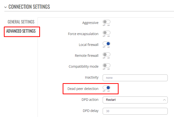

You can also enable DPD in IPSec → Connection settings → Advanced settings tab → Dead peer detection.
Let me know if this fixes your issue.
