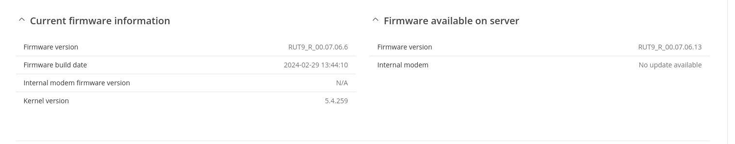

I’ve got trouble with my RUT950. I wanted to activate a SIM but keep getting “Internal modem is unreachable”.
Firmware shows:
Is there anything I can upgrade manually or check in the console?
I would be very glad if anyone can help. The modem seems to be EC25-EC.
