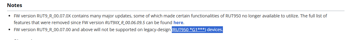

What firmware do you have? What firmware are you upgrading to? What’s your product code?
Check if it doesn’t contain G1:
if it does, the best you can upgrade to is the latest legacy version: RUT950 Firmware Downloads - Teltonika Networks Wiki
