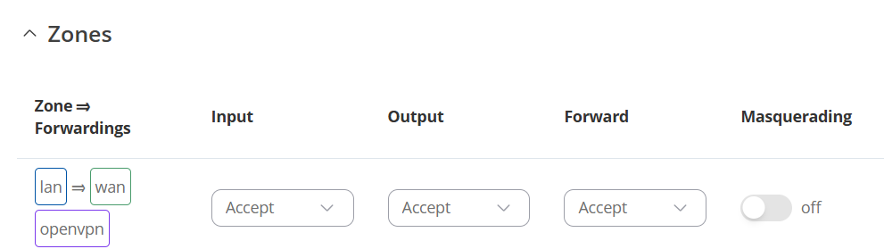

Alright, so since a VPN configuration is involved after all, I’d suggest trying enabling the Masquerading option for all of your available zones under Network → Firewall → Zones:
Your zone might look a little different than mine, but the suggestion remains. If that still doesn’t help, could you perhaps tell me what kind of VPN are you using?
Oki. I will try that at the remote site soon. But I’m not sure how that would help for traffic that is coming in on LAN and is going out again on LAN? Masquerading would not do anything to those packets since the RUT906 LAN IP would already be the src IP of any outgoing packets?
