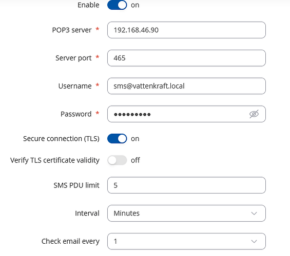

No then i use web configuration it will not connect to mailserver, then i check comunication with telnet and i get connection to server and wating for next comand. after that i try to make conection with thrue cli and configuration is identical to another rut906 as it work., and that router are runing firmware 7.13.3.
after check confiugration in cli i tray to restart email to sms service.
have also tray to reboot router but no difrent result.

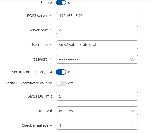

Please send screenshots of your configuration, while hiding sensitive data. Please also double both configurations, with working, and non working device, match them exactly.

Change your Server port from 465 to 995, assuming your mail server is offering POP3S (POP3 over SSL) on the standard port.
Also ensure:
The mail server at 192.168.46.90 has POP3 service running and listening on port 995.
Your email account (sms@vattenkraft.local) is enabled for POP3 access.
The firewall does not block access to port 995 from the router.
Arturas

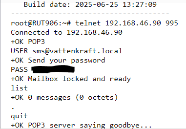

Hi, I have changed to port 995, email to sms does not connect.
I use telnet from the router cli and then I get connection, see picture below.
