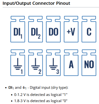

How can I utilize the 0-3V digital input when I’m using 24V for everything else? Is there a simple solution or do I need a separate power supply just for this?
A “Dry” input doesn’t need extra power. You can simply connect the pins related to this input for it to function. Check out our wiki for details on these pins and how to use them: RUT906 Input/Output Connector Pinout
