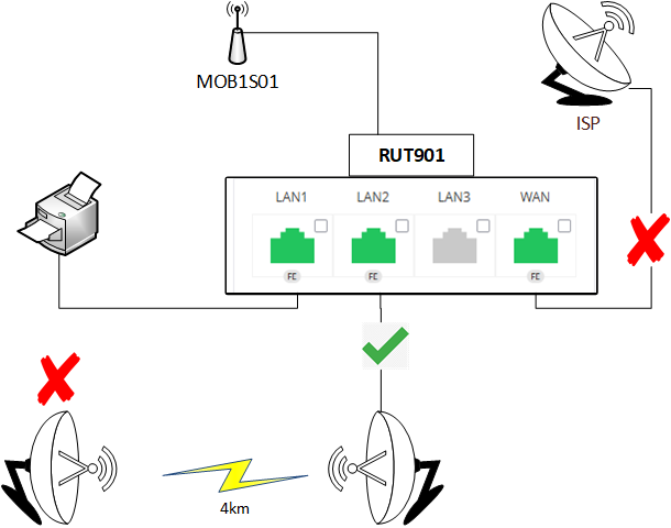

I have Failover set up from WAN to Sim. It works.
The problem is however, the Mikrotik (to the ISP) device plugged into the WAN port, cannot see the LAN1,LAN2 & LAN3 ports. The other appliances are also Mikrotik. They need to see each other, in order to work. When the appliance is plugged in the WAN port, I cannot ping its static IP, but internet connection is there.
IF I plug the ISP router into the LAN3 port, then the other Mikrotik appliances become visible, but then I lose the WAN Failover function.
Any ideas please? Thank you…

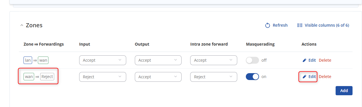

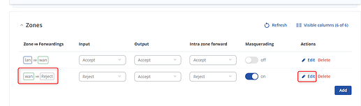

If it’s a routing issue, you need to configure a static route on the Mikrotik router to the LAN network of the RUT9, using the RUT9 WAN IP as the next hop. On the RUT9, you also need to allow forwarding in the firewall by editing the WAN zone and ensuring traffic between WAN and LAN is permitted.

This ensures that any traffic destined for the 192.168.1.0/24 network is sent to 192.168.100.100 (the RUT901’s WAN IP), and from there, the RUT forwards it to the LAN network. Since this traffic is entering the RUT901’s WAN interface, the firewall must be configured to allow traffic between the WAN and LAN. This can be done in the firewall settings under Network → Firewall → Zones → Edit the WAN zone, ensuring that traffic traffic from/to LAN is allowed.

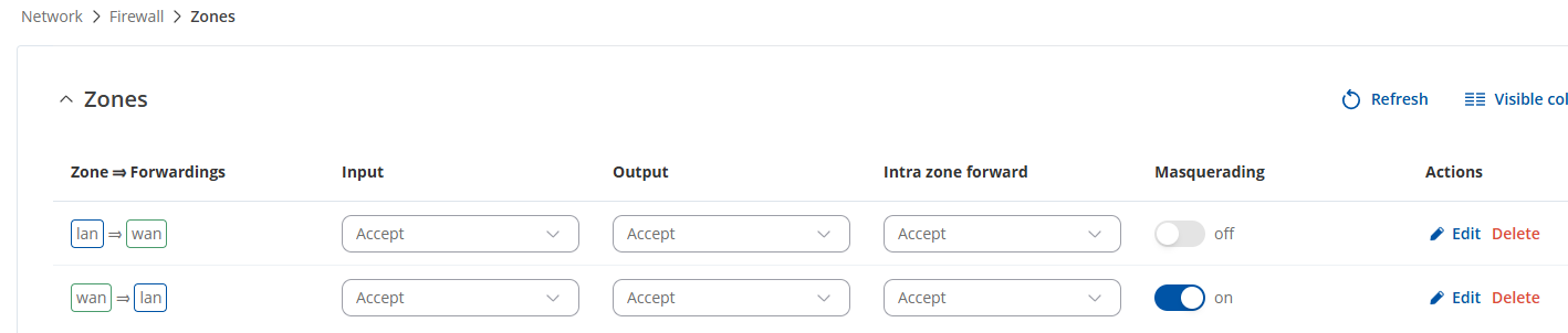

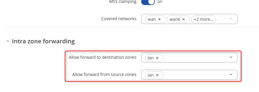

I have made some changes to the config as per your recommendation. I can ping both Mikrotik dishes on LAN2 and LAN3.
If I move the main dish to WAN (where it should go) then I cannot ping it anymore.

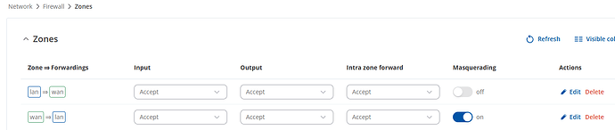

If I interpreted your message correctly, then I understand that traffic between WAN and LAN has been set up in both directions as per the screenshot: I however cannot ping the WAN port from the LAN (wifi) side…
@oscalot Hello,
The firewall zone settings appears to be correct.
