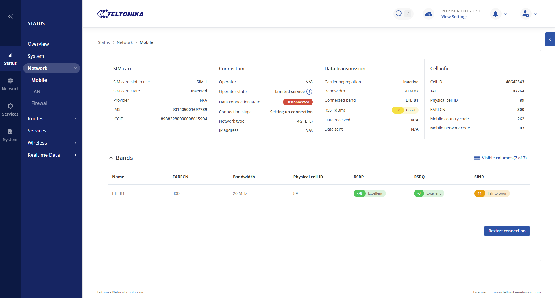

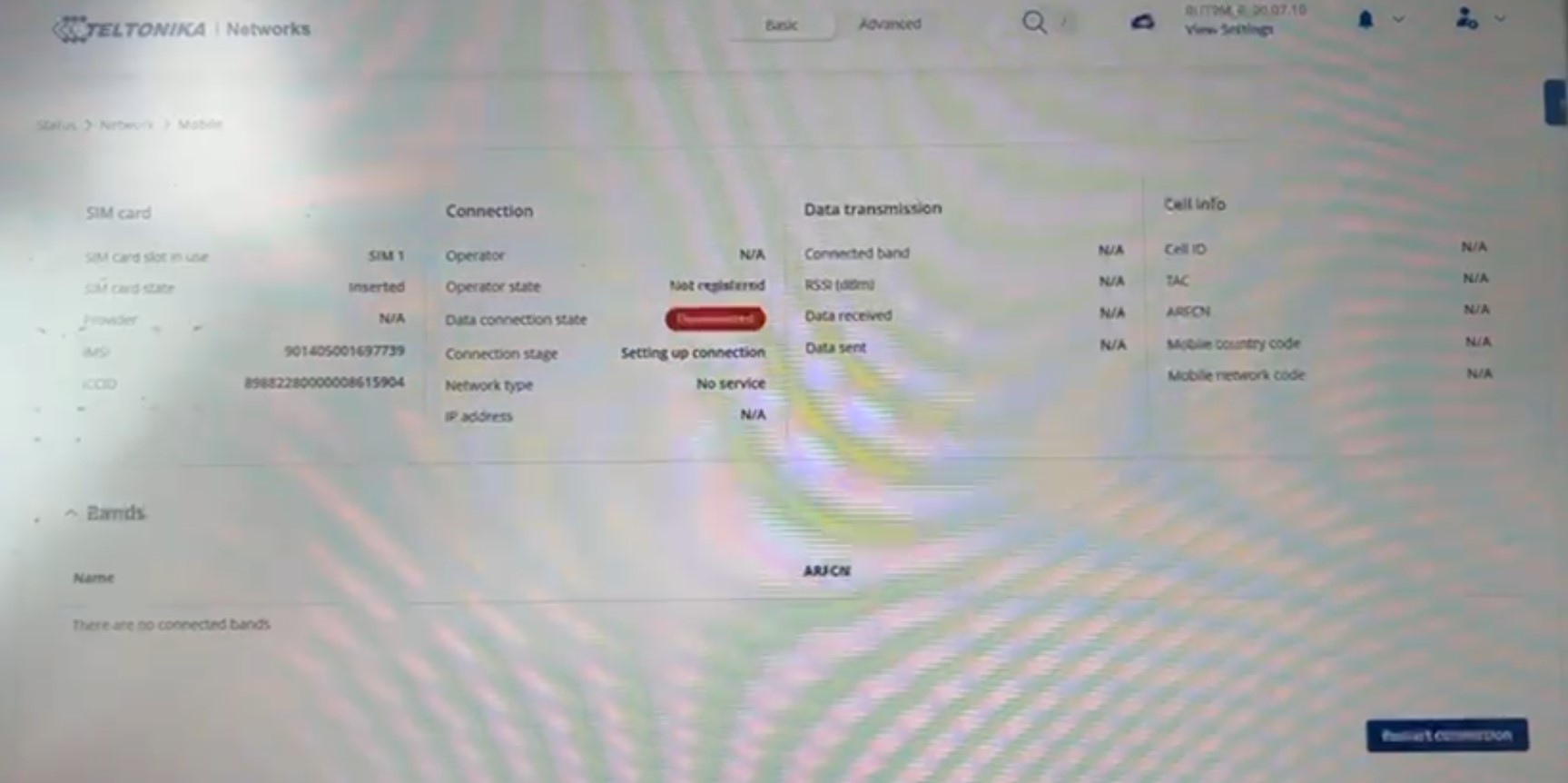

Seems like somehow the modem/SIM is not allowed to register to the network. The Operator state mainly remains as Not registered, but apparently every now and then the modem tries to connect and then for a while the status changes into Limited service.

(sorry for the poor picture quality, those screenshots are from a video recording that has been sent by WA…)

The steps provided in the other post are specifically for devices with a “Limited Service” operation state. Based on your second screenshot, I see that your device is in this state, so I highly recommend following all the outlined steps.

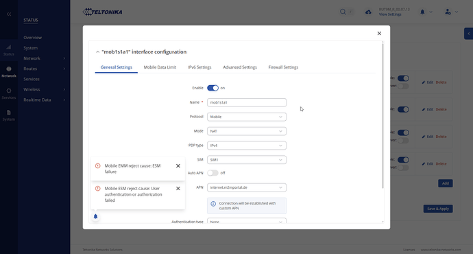

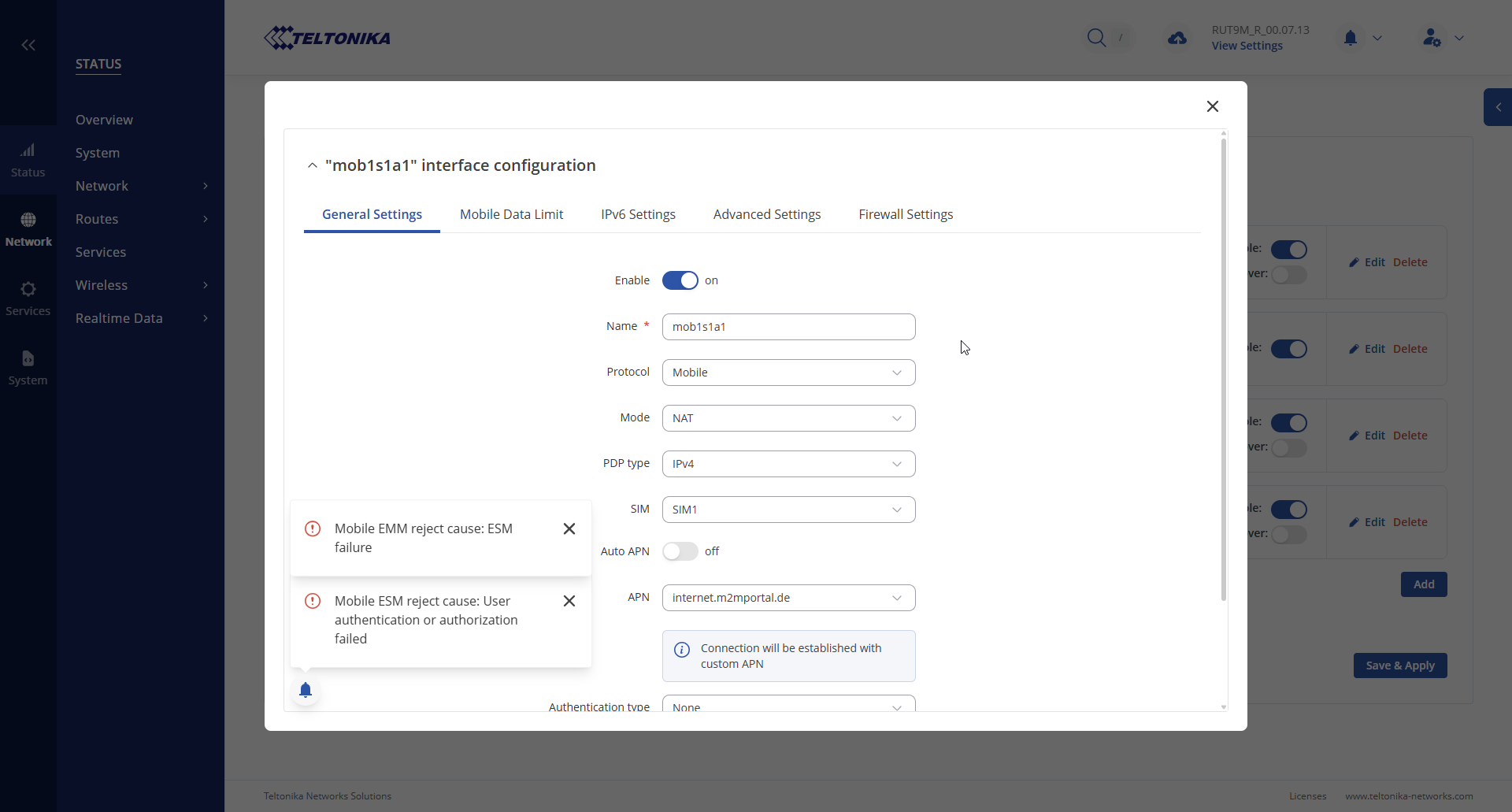

With 7.13.1, when changing the PDP type, do you encounter ESM failure and User authentication or authorization failed errors?
Could you please specify which PDP type you are trying to select when these errors occur?
Additionally, you can check the EMM and ESM reject cause codes here: LTE Release Causes.

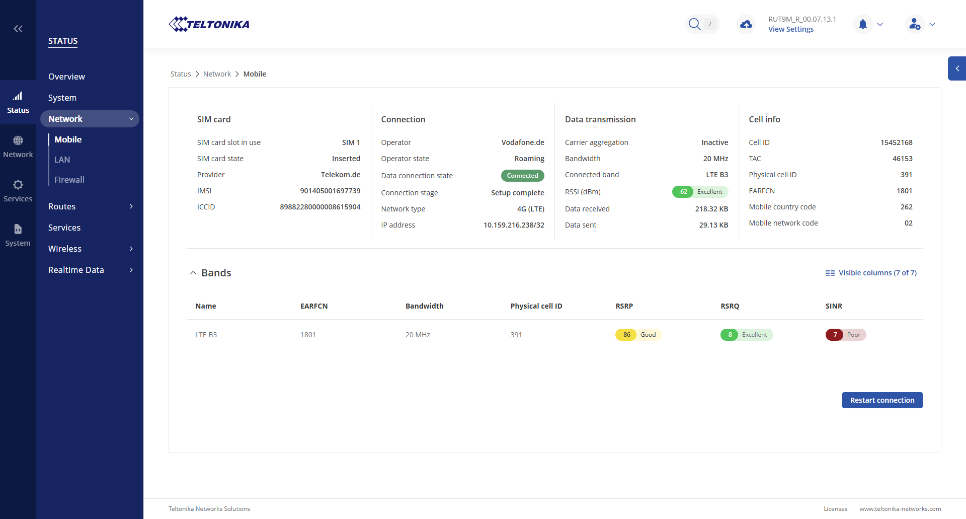

Hi. A few moments later we got some good news: “PDP type is IPv4. But now, after about 15 min it seems to work.”
I wonder was it now the very latest FW that seemed to fix the issue, or that IPv4 selection.
I’m no expert on these, but a bit funny if the dual selection (IPv4/IPv6) causes problems so easily… can’t the modem just automatically start using IPv4 only if IPv6 is not available for some reason.

The issue is most likely related to changing the PDP type to IPv4 only. When you select IPv4/IPv6, the device is instructed to attempt both IPv4 and IPv6 connections simultaneously.
However, when you select IPv4 Only, the device will only use IPv4 for the connection and completely ignore IPv6.
