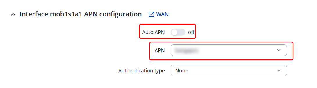

  2. Confirm that your operator doesn’t require a custom APN to be used, and if they do, please head to WebUI → Network → Mobile → General and disable Auto-APN:
