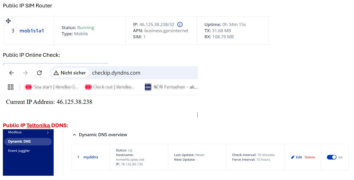

i use DynDNS (no-ip.com) on several RUT901 Devices.
On the last one - with the latest firmware Dynamic DNS works the wrong way.
I am sure that the settings are correct but DDNS does not push the Public IP to the Dyn Service, it pulls the IP that is currently used in the dyn Service portal.
If I change the IP online in No-IP - the router pulls the IP from there.
If I reboot the RUT901 and it gets an new IP - nothing happens - the IP does not get pushed to NO-IP.

Here the issue in Screenshots.
(I tested everything on an other Router (RUTM11) and it worked.
