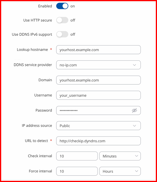

I have plenty of devices successfully configured for DDNS with a no-IP address, are you able to share an example of your configuration in the Dynamic DNS settings page? I’ve got a brief example here
Could you please clarify which error messages appear?
Additionally, as amadgwick mentioned, it would be helpful if you could share a screenshot of your DDNS configuration.
