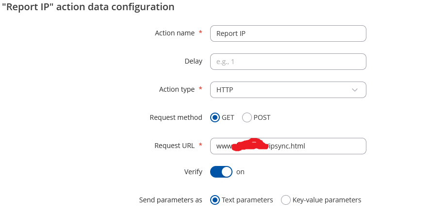

I am trying to get Event juggler to report some stuff on my web server. All is working at this point except that the Event (Event Type > Time, Action Type HTTP) is not using HTTPS even if I turned on “Use Secure Connection”. I also have valid (verified) certificate configuration (both CA and web server cert - openssl validated the cert successfully).
It seems even juggler is just ignoring the settings for HTTPS.
I did some testing with this and I am able to see the issue, I’ve inquired about this with our R&D and will come back with an answer as soon as they respond.
