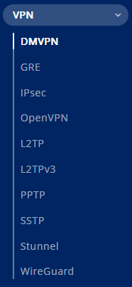

Additionally, it’s worth noting that PPTP is outdated and has numerous security vulnerabilities due to its obsolete technology. I suggest considering other VPN clients supported by our routers.
