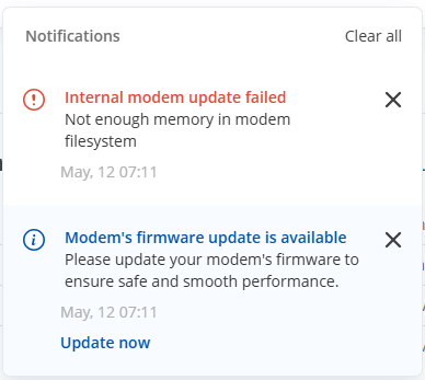

update: the modem seems to have an update but cannot update due to not enough memory

@lemondude we have tried that and still have that message. also disabled DHCP server, and access the router with static IP still not enough memory error.

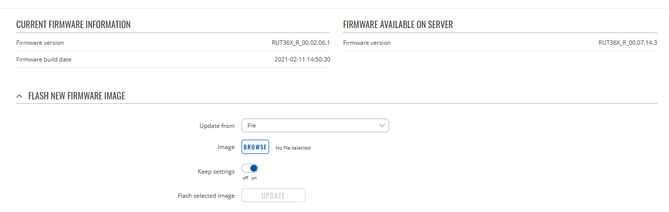

Could you please let me know which firmware version you upgraded from before installing version 7.14.2? Have you updated with “Keep settings”?
Additionally, could you check whether the same issue occurs if you downgrade back to the previous RutOS firmware? If the issue does not persist, please try upgrading directly from that version to the latest 7.14.3 firmware.
If the issue still occurs, please let me know.
The original firmware was RUT36X_R_00.02.06.1
There is no modem firmware update option on that version

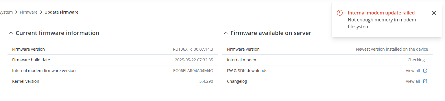

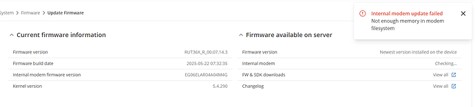

Could you please check if you are able to update the modem on RutOS firmware version 7.14.3?
Still unable to update
