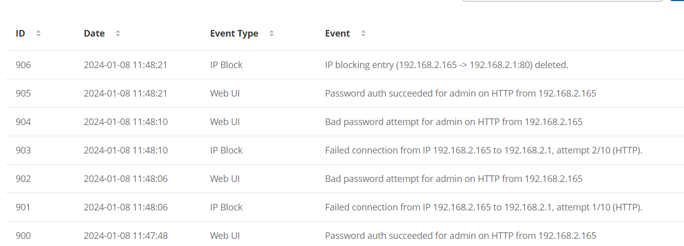

Just wanted to know that we have not yet managed to recreate the issue but there are a few points that are actually thinking of.
Can you check in your logs if you are being spammed or tried to log in because it seems that IP was blocked because of multiple failed tries.

Thank you for the reply.
How would I check for spamming?

As given above, it will be similar if you are trying to be accessed by an external party. Generally it was just for you to be safer and try to even change the ports for HTTP/HTTPS from their standard ones.

I don’t have that event listed so I still don’t know why this would happen.
