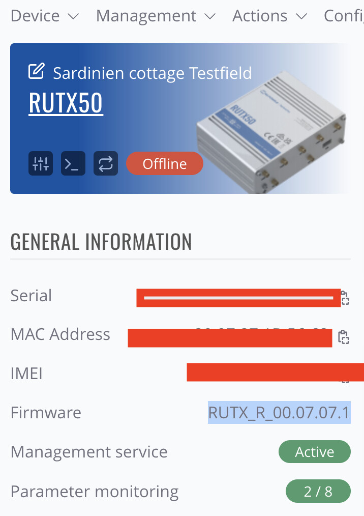

we have made that on a RUTX50 Device, which we have remote under control and where a Person was onsite. Update is done to RUTX_R_00.07.07.1, Device was rebootet and we have unregistered and unregistered.
We could work over RMS and had Remote Access. 2 People have accessed the Router at the same Time got a Session and after a while the connection was dropped. Device is now in Offline again in RMS.

to be clear, RutX50 was on newest RUTX_R_00.07.07.1 before and we have lost RMS Connection same behavior as with the RUT360 with RUT36X_R_00.07.06.10. Connection to RMS seems to be instabil.

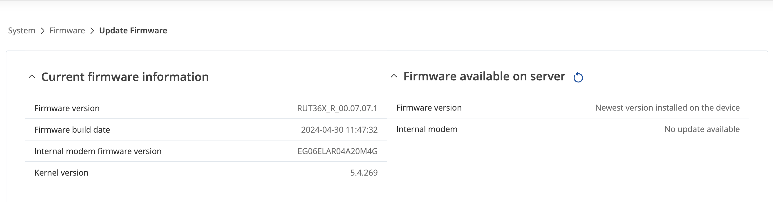

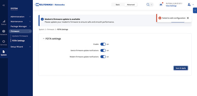

In the meanwhile, we have made the FW Update on Lab RUT360 and we tried to do a Modem firmware Update as well. But it tells us FOTA not enabled, If we do so, then we get the following Error when we do a Save and Apply.

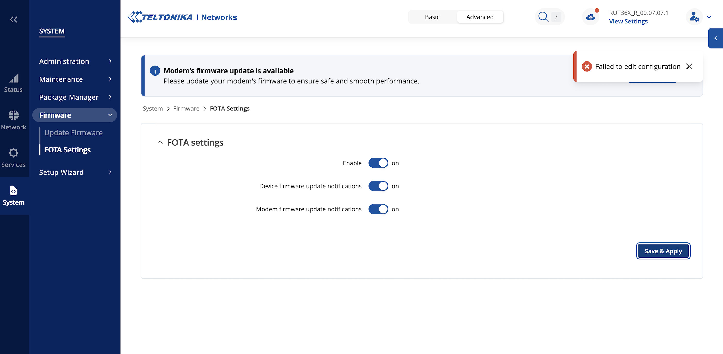

Any Idea ( guess it is also good to bring the Modem on the newest FW) why we can not edit the config when we do a save and apply ( I use admin Account)
Your FOTA config seems to be corrupted.
You can reset it by using SSH and copying the default config with command:
cp /rom/etc/config/rut_fota /etc/config/rut_fota
Thx, the Tip with the corrupted FOTA Config has worked :+1:
