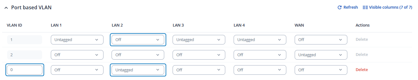

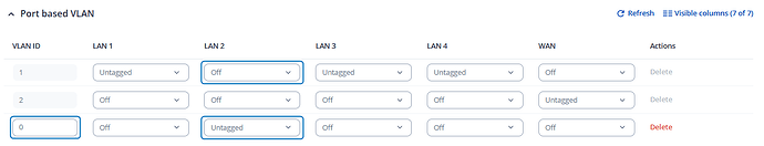

  • In similar cases, setting the LAN interface VLAN ID to 0 instead of 1 has resolved Profinet discovery issues. This can be done via WebUI, e.g.,:
    (set only on LAN port 2)

First of all, a big thank you to this community for the previous help. I’m happy to report that with your guidance, I have successfully configured my network, and PROFINET communication is now working perfectly on VLAN 0.

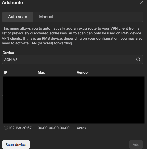

Edit:
Screenshot from Hub configuration:
I still have this problem, I would appreciate your help.
