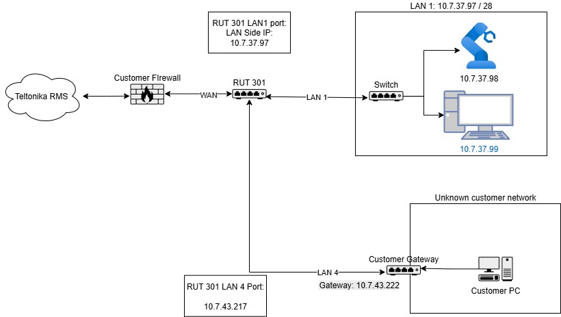

I am at my wits’ end with a customer. This is the current setup:
The RUT301 and devices in LAN 1 (10.7.37.97) are delivered by us.
The customer has provided connection to the Teltonika RMS on WAN side port of the RUT301. We want to use the RUT301 and Teltonika Cloud (VPN Hubs) for remote access.
Now the customer has another (unknown to us) LAN from which he wants to access data from a customer PC to PC 10.7.37.99. This LAN should be reachable via RUT LAN port 4.
The customer said we can use the IP 10.7.43.217 and the gateway is 10.7.43.222.
At first we wanted to use port forwarding on WAN port so the customer can access the data from the RUT 301 WAN side, since there is another customer firewall in beetween. Sadly this is not allowed according to our customer.
I have a feeling that this whole setup can’t work, at least I do not how to configure it.
Does anyone here have any ideas?

I do think there is a misunderstatement:
The wan port on the RUT301 works (and I prefer not to change that :smiley: )
Problem is the LAN on RUT301 LAN Port 4. You mean I need to set up the LAN4 Port as another WAN port?
