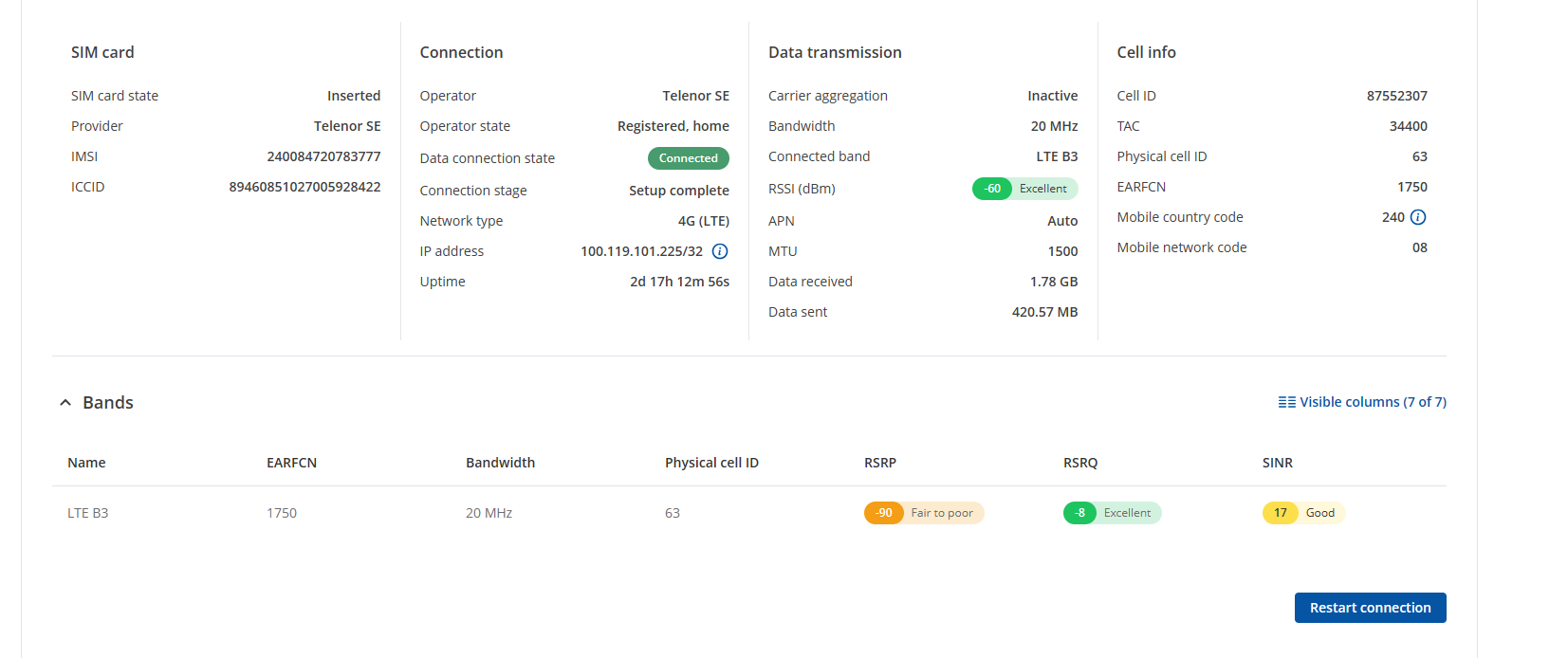

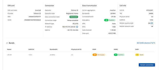

  5. It would also be helpful if you could provide a screenshot from Network → Status → Mobile with any sensitive details hidden (such as public IPs, IMEI, ICCID, cell ID, etc.).
  6. Additionally, could you let me know which operator you are using and whether they support 5G SA or only NSA?
  7. Lastly, does the modem connect to an LTE network instead, or is it unable to register on any network at all?
only 4g led is on, and its connects to 4G (telenor sweden), sim has no pin, i can put my sim in a tp link 5g routern here on my desk and it works with good connection on 5G, i have tried auto and manual APN.
