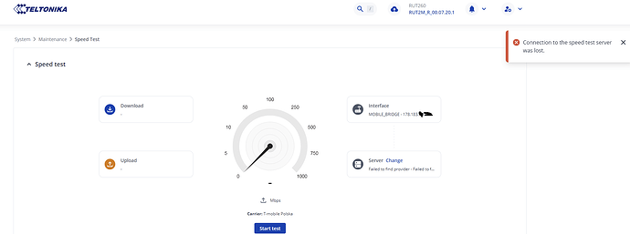

I use Teltonika RUT260 (set to Passthrough mode) with latest available firmware RutOS 7.20.1.
My problem is that System → Maintenance → Seed Test GUI detects my interface 4G/5G Mobile Carrier T-Mobile in Poland and list of available Server, but when I click GUI “Start” button in test it tries to connect, but soon I’m getting error messages with “Connection to the speed test server was lost”or “Server Failed to find provider - Failed to find IP
I tried with few different servers from SpeedTest proposed server list in Change button
(it detects servers normally) and generally problem is the same, nothing starts.
I tested out different WebBrowsers - MS Edge, Mozilla Firefox 147 no Adblock, Chrome - whatever browser I use, problem remains the same.
Screenshot how it looks like:

I was able to recreate this issue on my device as well. I will reach out to our Research and Development team regarding this matter, and once I receive their feedback, I will get back to you.
Any update from Support Team where they can create correction and deploy hotfix?
Hello, @roberttz,
I am still waiting for an update from our R&D team. As soon as I receive more information, I will let you know.
Thank you for your patience.
