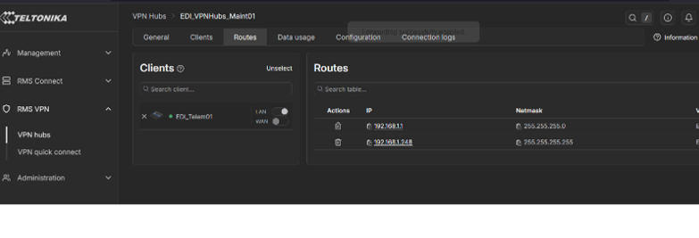

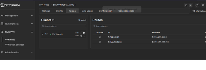

Creating the HUB works without any issues: I add a USER, a DEVICE, set up a route to the 192.168.1.1/24 network (for testing), and finally I enable LAN Forwarding.

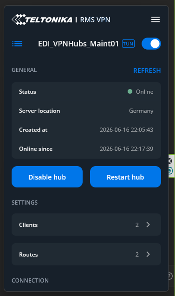

I then reboot the hub and connect using the Teltonika VPN client.

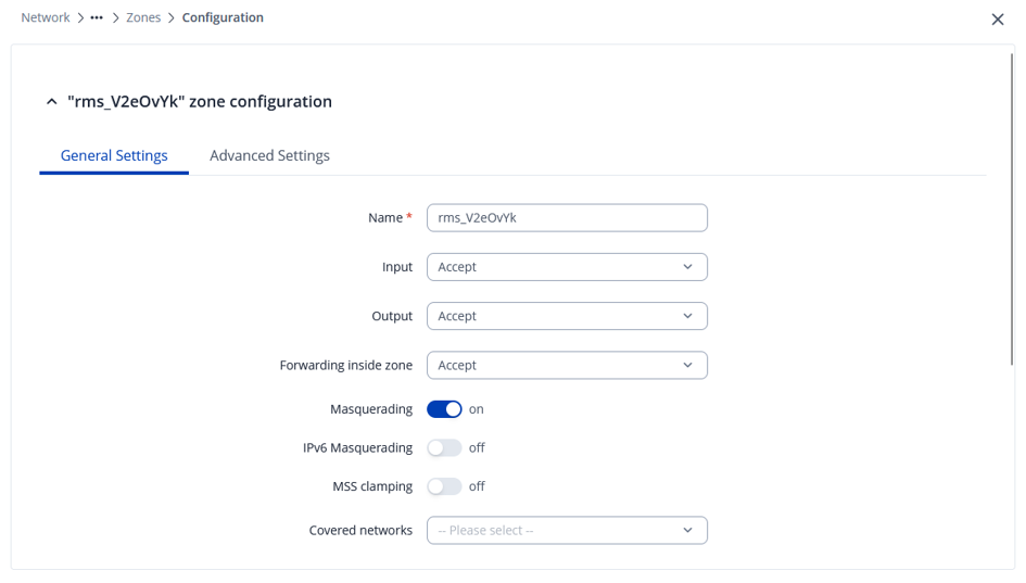

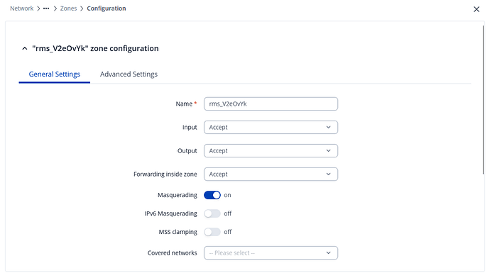

On the router side, in FIREWALL → ZONES, I enable masquerading, then edit the RMS > LAN rule. At this point, the “Covered Network” field is empty.
From my client side, the LAN gateway is not reachable, nor are any devices on the LAN.
