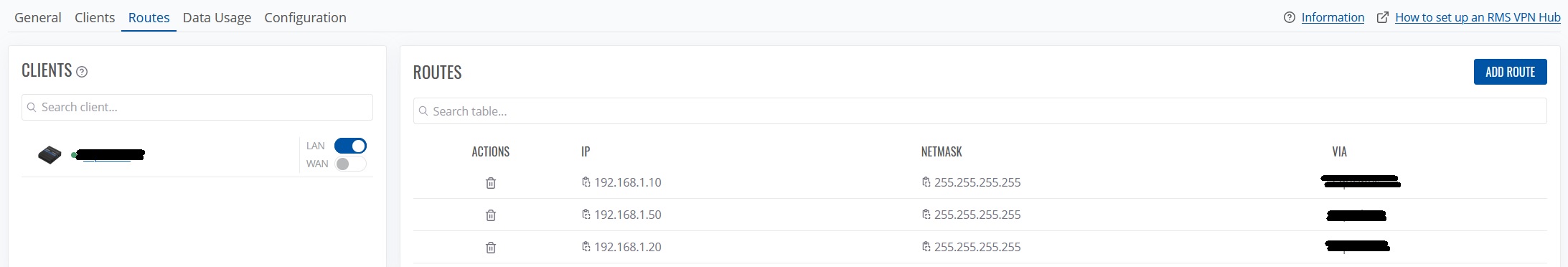

I have RUT241 (FW: RUT2M R 00.07.04.5) connected to some automation devices which I try to acces through RMS VPN hub.
They are all accessible through the local LAN if the RUT241 (PING and HTTPS) but NOT when I connect through the VPN hub. The hub is up and working. I have tried to delete the hub and make a new just to se if the problem was in the hub (German server).
The routes are setup according to the image below.

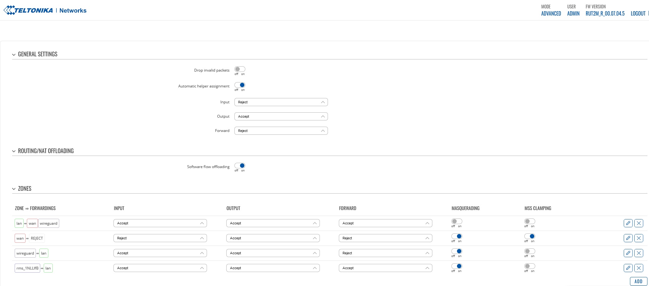

I’ll ask you to post a screenshot of the General firewall setting on the RUT241 by navigating to Network → Firewall → General Settings. This may be able to help us determine if the issue could be on the router itself.
Additionally, could you try deleting the existing routes, and adding a route to the entire 192.168.1.0/24 subnet?

I have replaced the three routes with (192.168.1.0, 255.255.255.0). Still the same.
The general firewall settings are as shown in the image below.

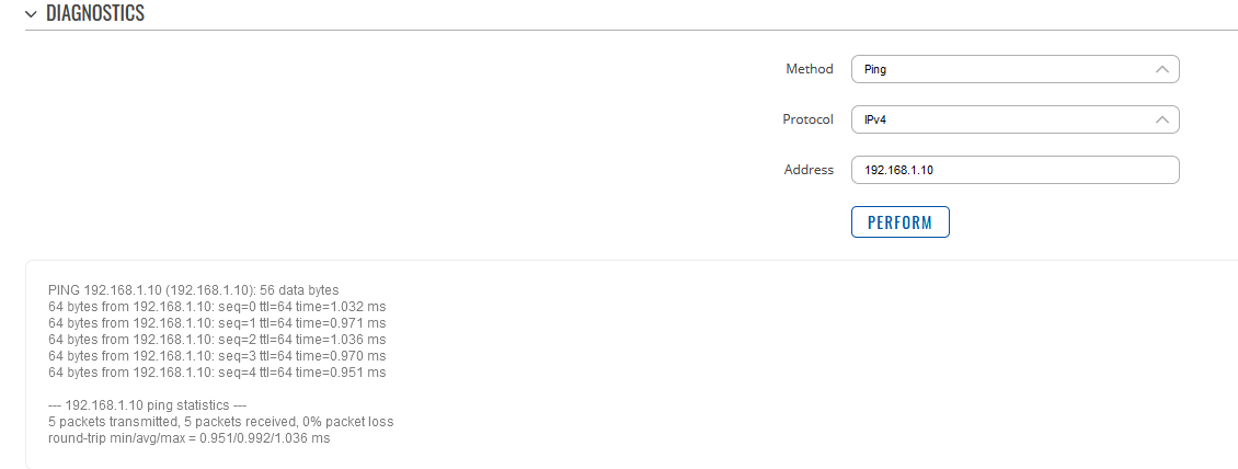

I also tried to ping 192.168.1.10 through the webUI, which works.
