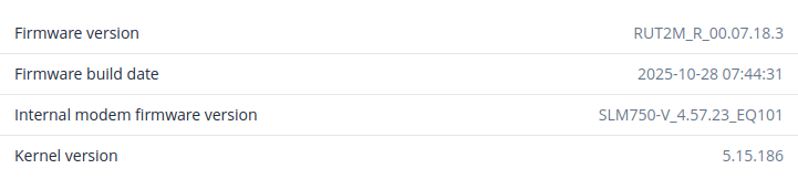

I’d like to see your exact firmware version, modem version & logs of your troubleshoot file of when the issue is present within the device so I could review what’s really going on. For that, I’ve sent you a form to fill out. In the Ticket ID field, simply enter the number 16543. After you’ve done so, I’ll reach out to you through your provided e-mail shortly.

This problem has existed on firmware 7.13 not sure prior
