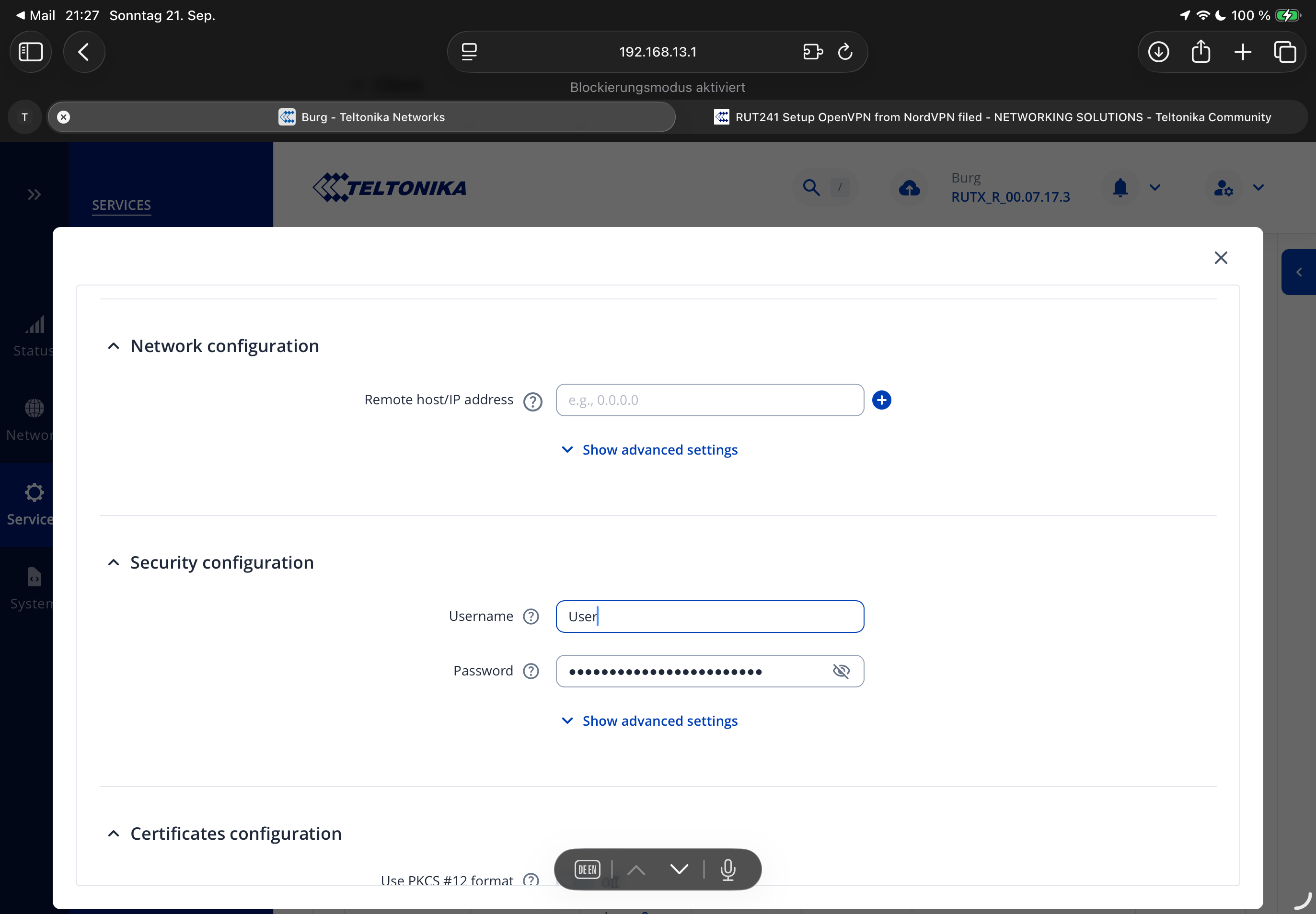

I have found a way to put in the credentials, but now i have these entrys:

„Edit“ the profile from nordvpn
Try the options badage like „security configuration“
Click and you will find a username and password field
Add nordvpn given credentials and
Save that and open latching button in interface
Do not edit the ovpn file
Just upload and edit the options in rut ui
