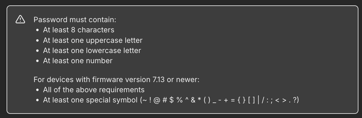

It does not even work for me after setting it up in the RMS management page, i still get “Password does not meet requirements”.
The passwords i have tried are:
  • Password1!
  • Z0wuDMVAasd123asd*
  • }Z0wu+DMV
Those do not work.
But they pass these requirements:
I have tried both with /set and /upload endpoints, they don’t often work.

Troubleshooted a bit, if the RUT has not connected to RMS yet, it will just return password does not met requirement, even if it does. It needs to be connected first, for some reason.
