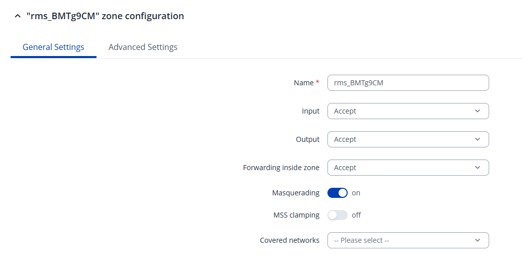

I have RUT241 registerd to RMS,using openVPN.
the masquerading is enabled.

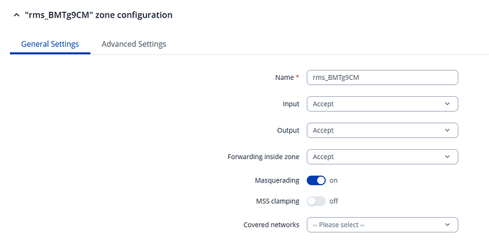

Could you please navigate to Network → Firewall → Zones, click edit on the OpenVPN zone and enable MSS clamping, test if that solves the issue.
Tried that and didn’t help,

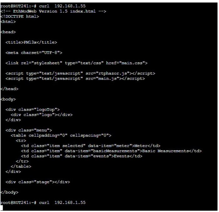

Im inside the router SSH,
making http request via curl, it works for the first time and not for the second time for a while. then it works again for one time
tcpdump show shows that on the new http request no new packets are sent from the router to the device

In your last response, you mentioned that a curl request from the router works the first time but fails afterward. Based on my understanding, accessing the device via HTTP does not work reliably even when using a physical connection, not only over the VPN. Is that correct?
