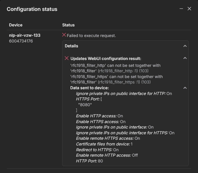

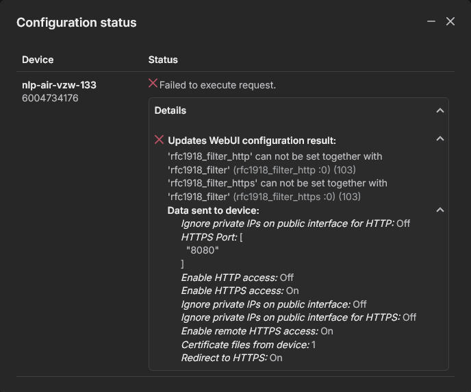

I’ve been trying different remote access settings, but I keep running into an error every time I apply the configuration from RMS. Please help!

Thanks, but I need remote access for connecting to the RUT via VPN after the initial RMS credit expires.
yo, in that case, why not login to the device directly via the WebUI access that MatasR has sent, and change the settings manually by going to system → administration → access control?
looking at your screenshots, not even sure what you’re doing wrong here lol, looks like you’re getting rejected for some reason, is the device even online?
Anyways, I’d suggest following what i wrote in the first paragraph and you’ll be set ![]()
Hello, as @minecraft_creeperis inquired, does accessing the device directly work for you?
Remote access can be set up directly, via the WebUI, by heading to System → Administration → Access control
If any further help is needed, do let us know,
