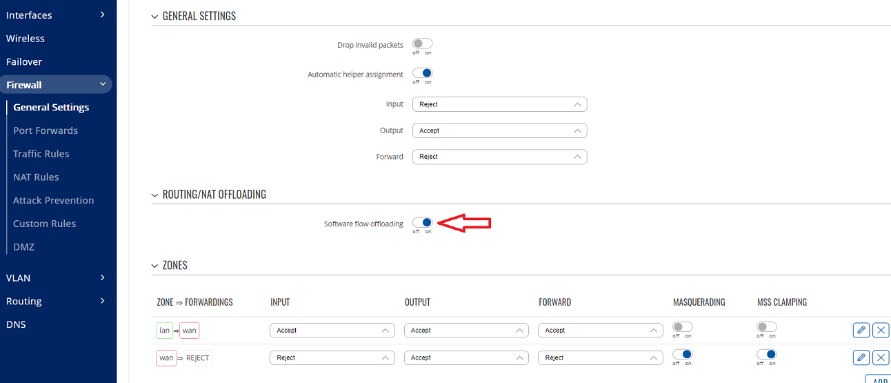

Also you have the option called Routing/NAT Offloading, The device checks whether the flow (sequence of related packets) is of a received a packed is known. Packets of unknown flow are forwarded to the networking stack. Meanwhile, if the flow is known, NAT is applied (if matched) and the packet is forwarded to the correct destination port. This way, the packets are able to traverse though the firewall quicker and it results in better throughput. Navigate to the Network → Firewall → General settings and enable software flow offloading
