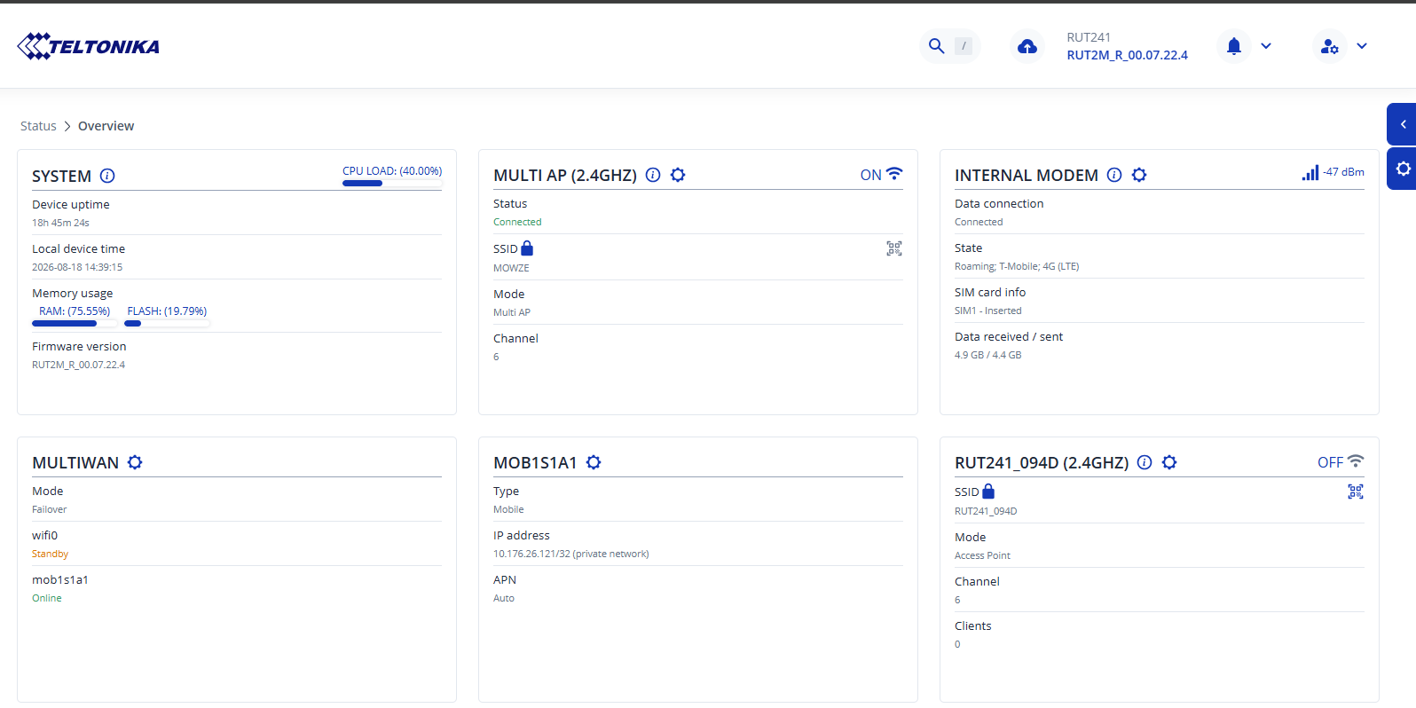

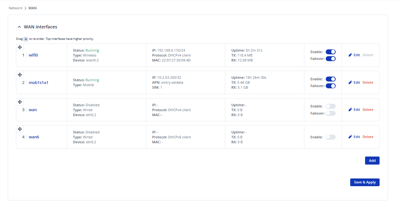

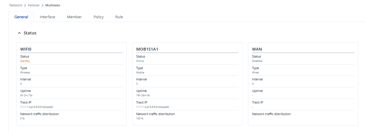

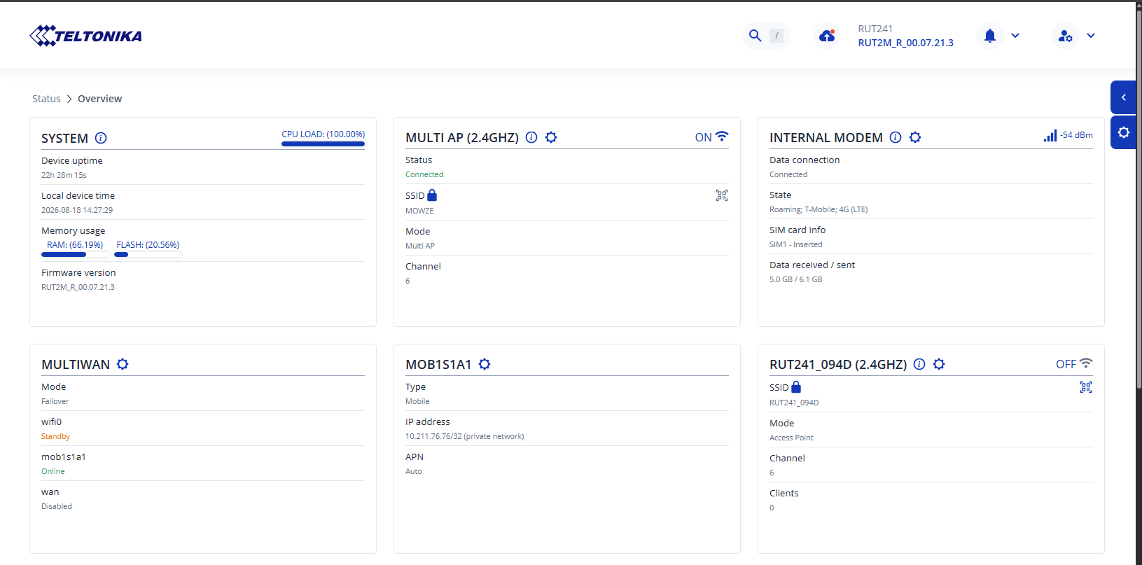

WebUI. I tried it keep it simple as possible. MultiAP is used for the WiFi WAN.
BTW: at the end there are some screenshots of how it is setup up in the webui.
3
As far as I can tell, yes. As of Monday AM, two of the robots had failed. I grabbed the outputs from both of those.

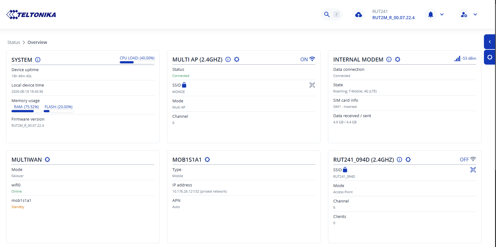

I’ll add a couple screenshots from the webui of robot B:
Thank you so much for your help! Hope this is enough to track down the bug. I did update to the latest version of RUT241 firmware on one of my robots - (not either of the two that failed) so if that one fails as well I will post here.

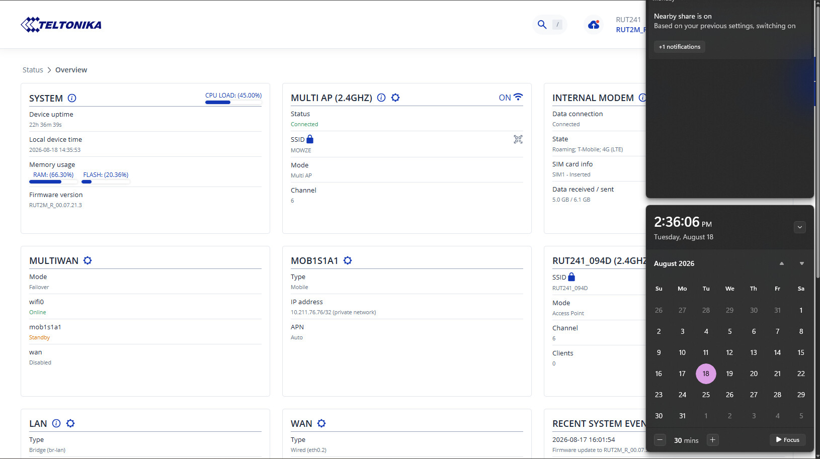

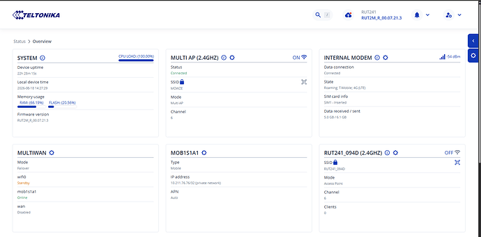

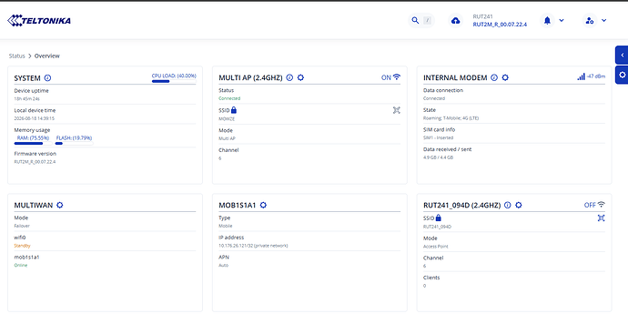

Whoops! Sorry for the delay.
Of the 13 robots near our WiFi - 3/13 were on cell.
The problem occurs on modems version RUT2M_R_00.07.22.4 and version RUT2M_R_00.07.21.3.
Logging into one of the modems - first on the webui to check the problem is happening:
Confirmed - I see wifi on standby, when connected.
Ok now to ssh:

After running
ifdown wan1
ifup wan1
I saw the multi ap status go to “starting”, and then the failover fixed itself, and then multiap status went to “connected”. See below.
With one of the other devices (this one Firmware: RUT2M_R_00.07.22.4), I connected and tried the mwan3 restart as well.
Before running the command:
and then after running the command
It was successful as well!
If I understood correctly, restarting the interface resolves the issue. As a temporary workaround, you could consider creating a custom script that detects when the connection becomes inactive and automatically restarts the interface.
