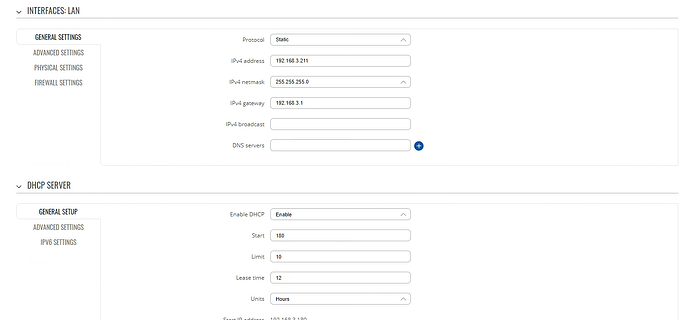

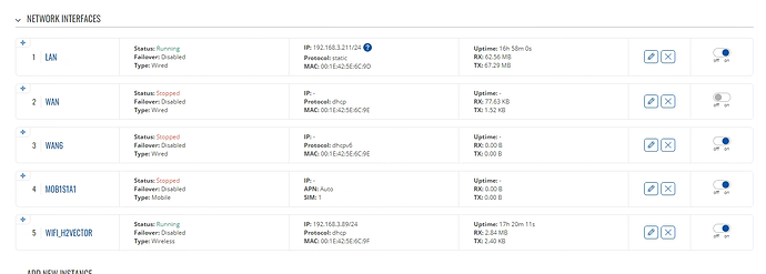

Hello, I am trying to connect the RUT241 via wireless to another router so that it provides internet to the RUT, but this does not happen.
The configuration is the following:

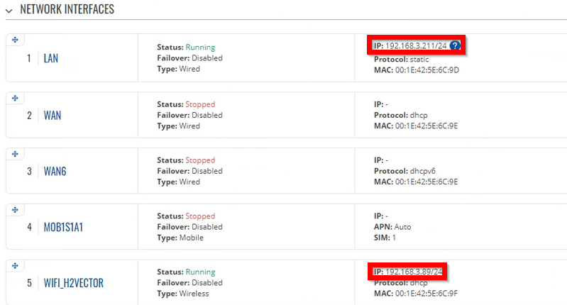

Currently, you have two network interfaces with the same subnets (192.168.3.0/24).
It’s essential to assign a different subnet to your LAN network.
