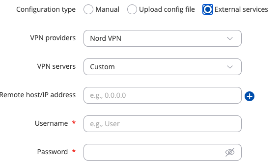

When choose " external services "
You will have the option to add user/password.
So…
I first upload my ovpn file, using upload config file.
Save and apply.
Open second time, change to external service, change to nordvpn, custom address… I look at the address at the ovpn file (it is a text file) address after remote word
type my username and password.
Save and apply, again.
Works.

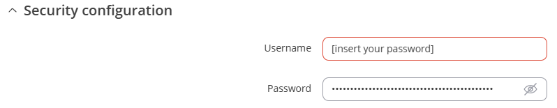

You’ll need to got to SERVICES > VPN > OpenVPN > [your vpn name] and expand the section titled SECURITY.
By default the sections are masked and you have to click on the V arrow to expand.
All is revealed in the RUT241 manual should you feel the need to read it.

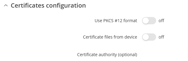

Thank you Mike. In this path, I need after the security configuration a certificate authority file, which I don’t have as it was never needed before.
I think I have to wait until my provider issues a new guideline for this update. And I have to ask my customers for excuse for the delay.
Hi Urmal, probably best to see if your VPN provider can provide the manual settings or even better, an .ovpn file that you can upload the settings.
The CA cert can be optional, so one thing you could try is …
a) set authentication to Password
b) Enter your credentials …
c) leave the Certificate Authority field empty …
I think though, you’ll have a smoother journey if your VPN provider can give you the settings or a file to upload.

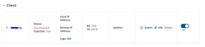

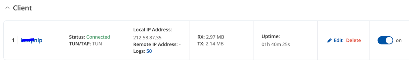

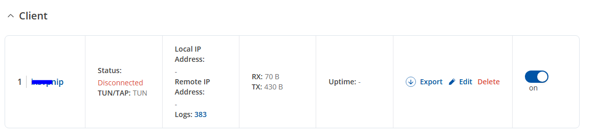

OK. One thing looks strange to me. I made screenshots from my previous working installation, and there it looks in the following way:
Its showing my static ip adress. When I compare this with I have now, I miss this information. Is there an input field I oversaw? The entry local IP adress is empty. Or is this simpy a result from the not working connection
Have a look at your logs … is there no documentation or another person in your organisation that could help?
