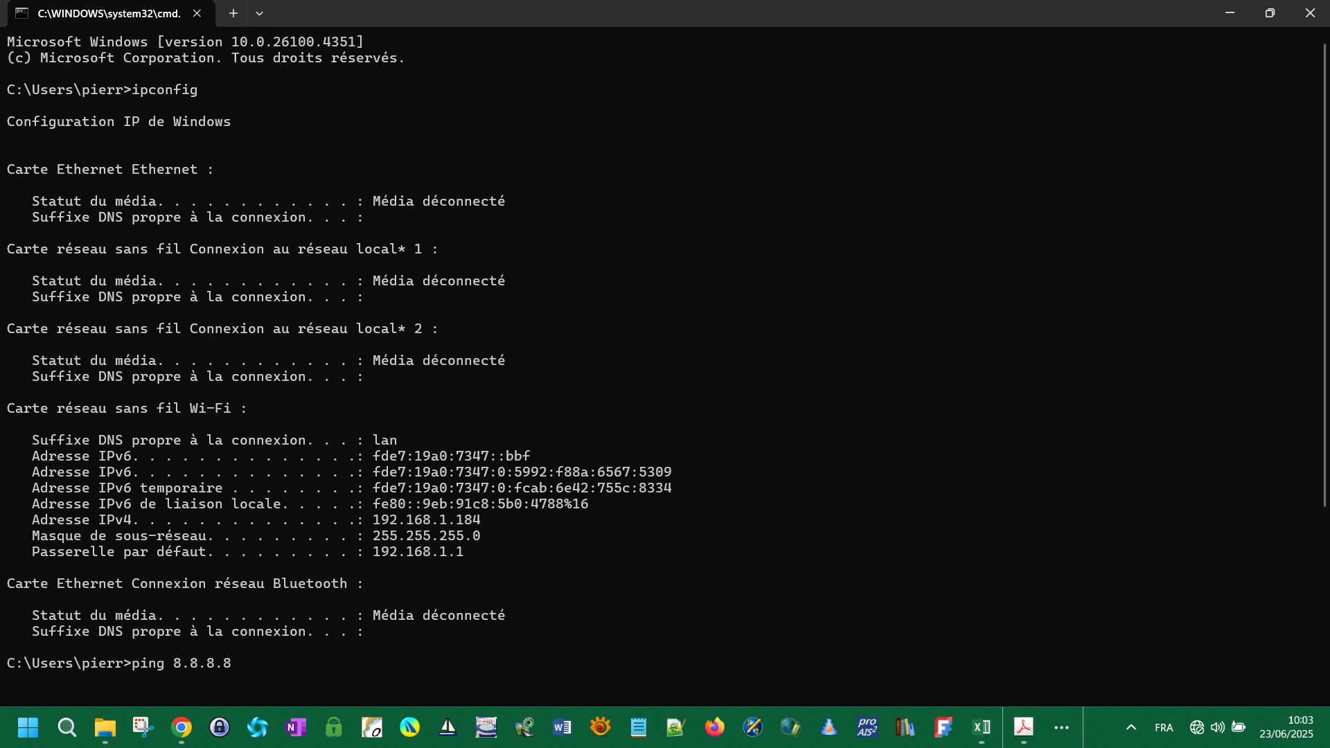

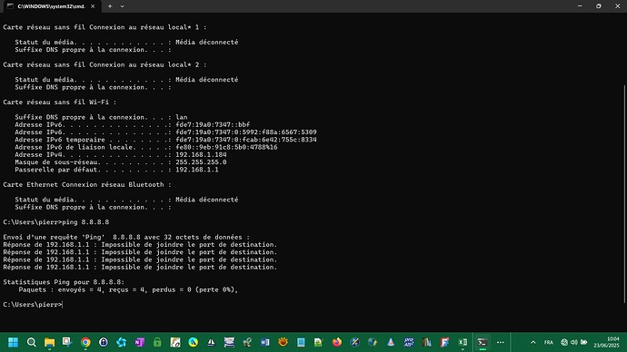

The RUT241 is equipped with a SIM card (dedicated to data), and everything looks fine (e.g., the mobile status). When my laptop is connected to RUT241_0A40, I can connect to the administration site (192.168.1.1), and also at least to another device configured as a client. Conclusion: no problem to connect to local addresses.
However, the access point does not provide internet. Most parameters are set with the default. I am probably missing something so that internet data exchanged via the SIM card are not seen through the router access point. I tested without successh 2 different SIM cards (which both work fine to access internet when inserted in android devices).

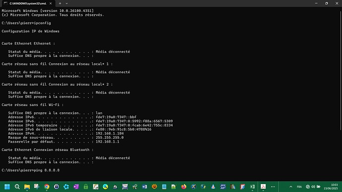

Thank you for your support. Sorry, I didn’t reply to the correct address. The attached screenshot show the result
Could you please perform a ping test from the router’s WebUI?
You can find more information and instructions here: RUT241 Diagnostics – Ping Test
sorry, my error!
Here is a copy from the proper router’s WebUI:
