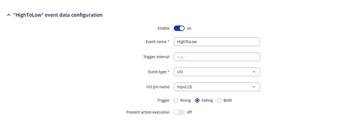

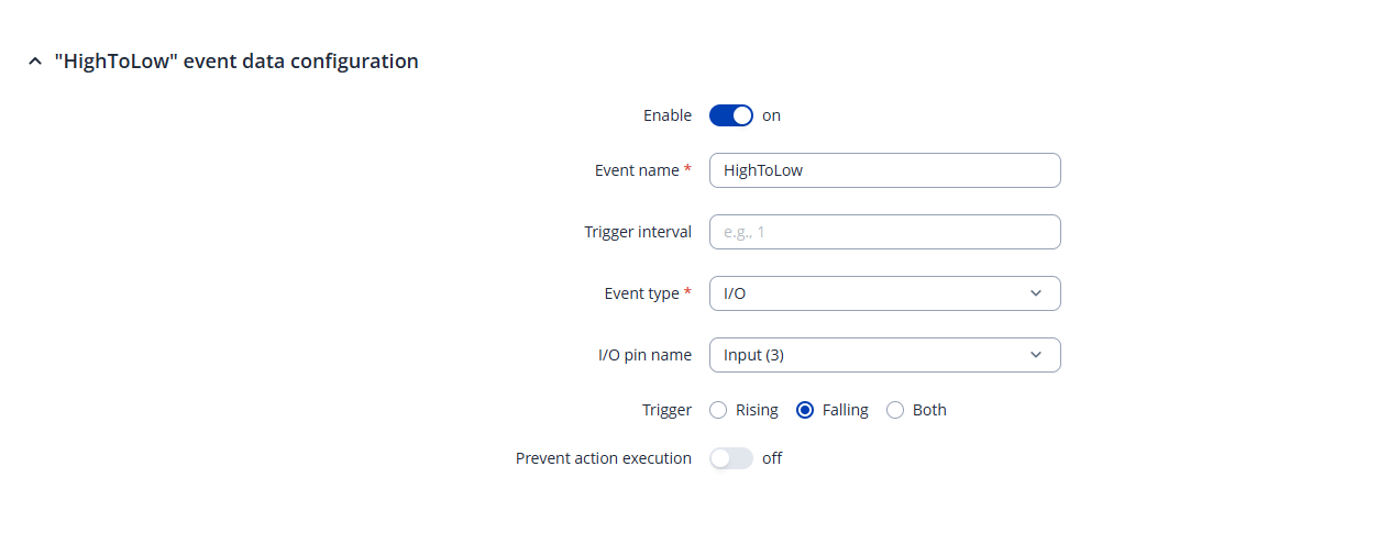

To configure this, navigate to Services → Event Juggler and click Add.
Set up the Event Data Configuration as shown in the image below.

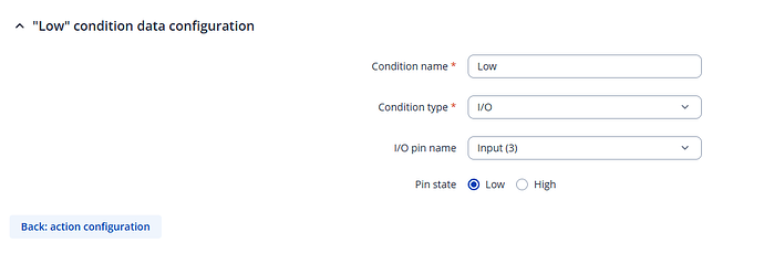

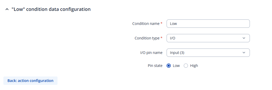

Next, scroll down and add a condition as shown in the image below.
Finally, click Save & Apply and Finish to complete the setup.
