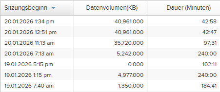

since 20. January 2026 until today, this RUT241 consumed 2.5GB Data on a Multiromaing SIM for data coming from compute.amazonaws.com.

just for the information that most of this data usage came from AWS, In/Outgoing traffic on LAN is blocked, theres only one static lease allowed to talk outside, this device is actually disabled and the traffic from AWS didnt stop.
The VPN is not in use and the history shows <1 MB the last 10 days.
With 20 January the extreme data usage started.
