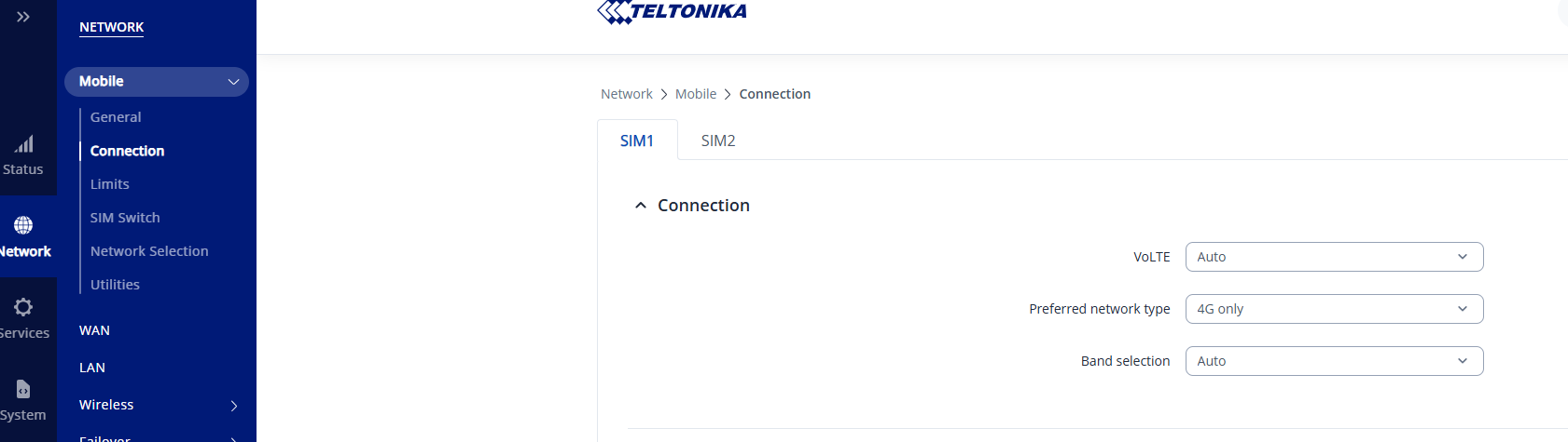

Next, please go to Network → Mobile → Connection, change the preferred network type to 4G only, and check whether the issue persists.

The 3 minute interval was very consistent (+/- a few seconds). Auto Reboot is not enabled. I have changed the network type to 4G only. Should I also engage Low Signal Reconnect? It is normally around -70.
