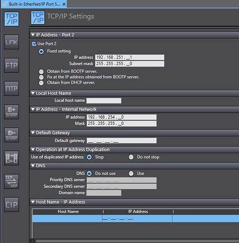

PLC side settings

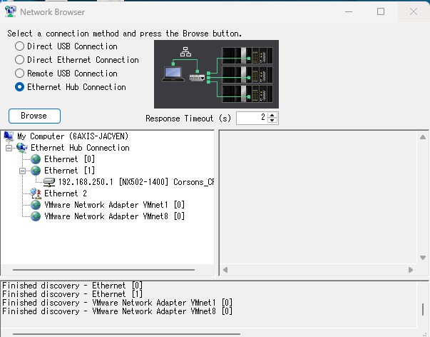

When I connect the Lan to laptop the PLC is visible

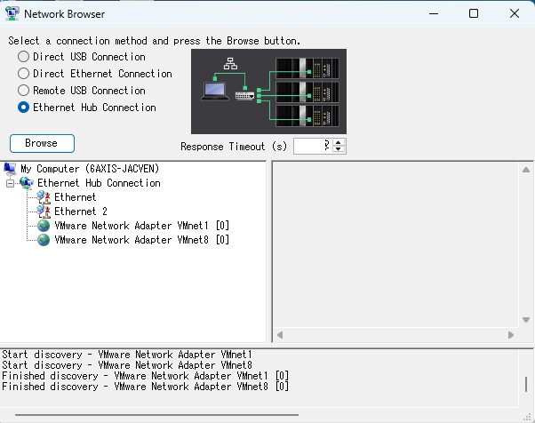

Disconnect Lan and connect to VPN via OpenVPN GUI nothing is detected

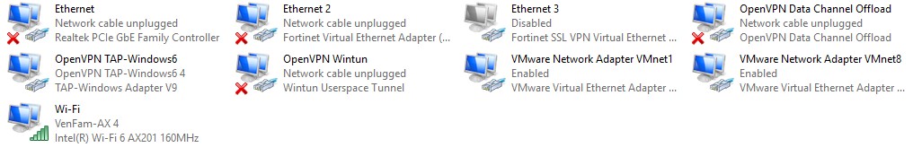

Network adaptors when VPN is connected
