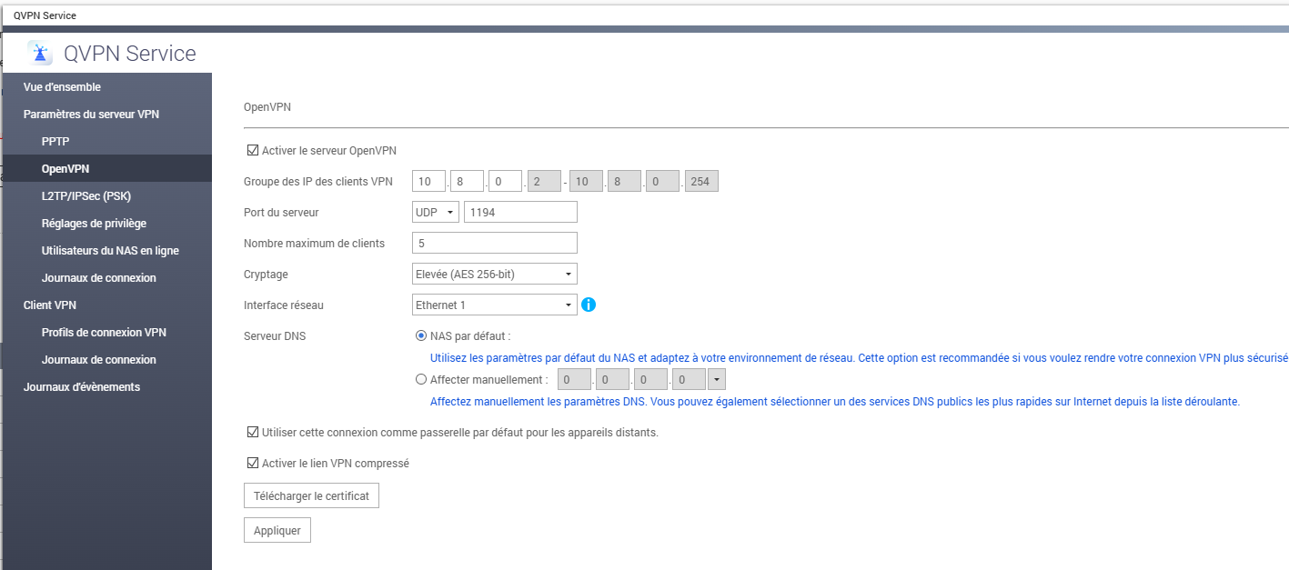

On the server side (Linux), I have this configuration.

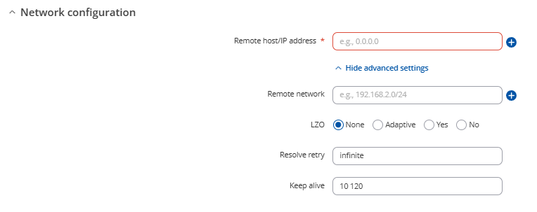

My question is, what IP address should I enter in the “Network Configuration” parameters?
I have tried entering the server’s public IP address, something like 178.x.x.x, and the address 10.8.0.2/24. I have swapped them around, but I still haven’t been able to establish a connection.

If not, regarding your question, in the Remote host/IP address field of the OpenVPN client configuration, you should indeed enter the hostname or public IP address of your VPN server (which, as I understand, you have already tried).

  • If possible, could you also provide the OpenVPN logs from the client side (RUT241) and, if accessible, from the server side as well?
  • What are the LAN IP addresses of both your server and RUT241 client?
